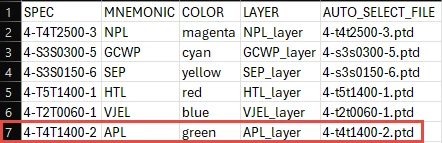

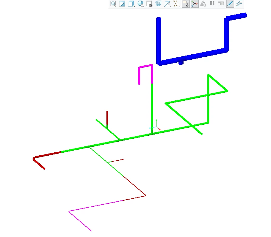

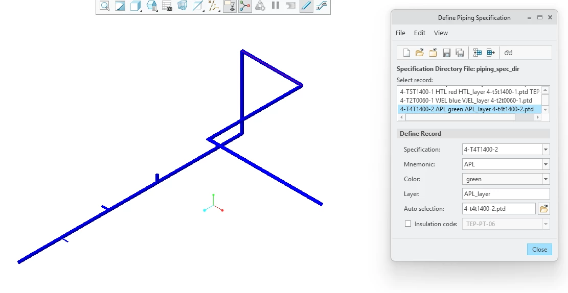

As shown in the image below, I have defined a pipe spec that has a particular color assigned to it (in this case, green). This spec is shown to be this way in the associated Pipe Spec Directory file as well. However, despite all of this, the pipe keeps showing up as blue! I’ve updated the pipe model and regenerated the assembly but nothing seems to work. What might be causing this issue?

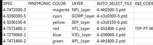

Okay I’m not exactly sure why this seemed to fix the problem I was having, but apparently deleting information pertaining to the Mnemonic section corrected the coloration issue. The question is then…. why???
