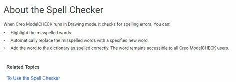

ModelCheck provides spellchecking for Creo drawings...and more.

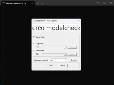

I tried running modelcheck for a creo drawing, and received nothing.  After entering the drawing file number and selecting "Run", the background disappeared.  Are there some posted instructions somewhere to understand this process in more detail?
Dec 9, 2024 7:36 PM UTC
Is this in your config.pro? modelcheck_enabled yes
Have you looked at the default_checks.mch file to be sure the proper checks you want are being executed?

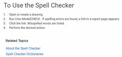

You can find info on the spell checker in the Help Center.  So far, I have not been able to get it to work, but according to below instructions, it's supposed to be easy.

@BenLoosli has the right answer. You have to configure model check for spelling. Configuring model check can be a bear. The line you are looking for is this one:
NOTE_SPELL YNEW W W N W Y
It will be under <Model Check Root Install Folder>\config\check     in one of the mch files
Dec 10, 2024 2:30 PM UTC
Have you run ModelCheck in Interactive mode with your drawing open?
