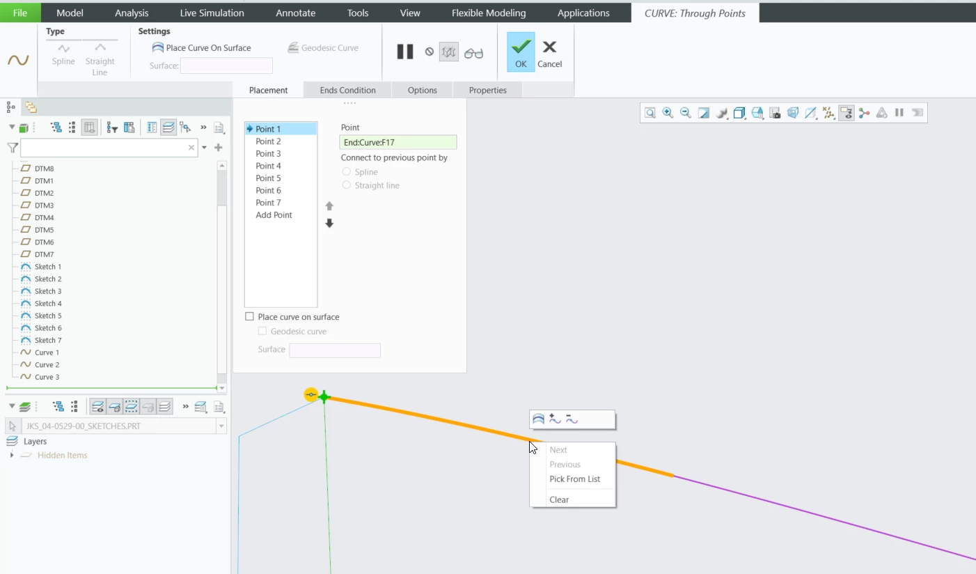

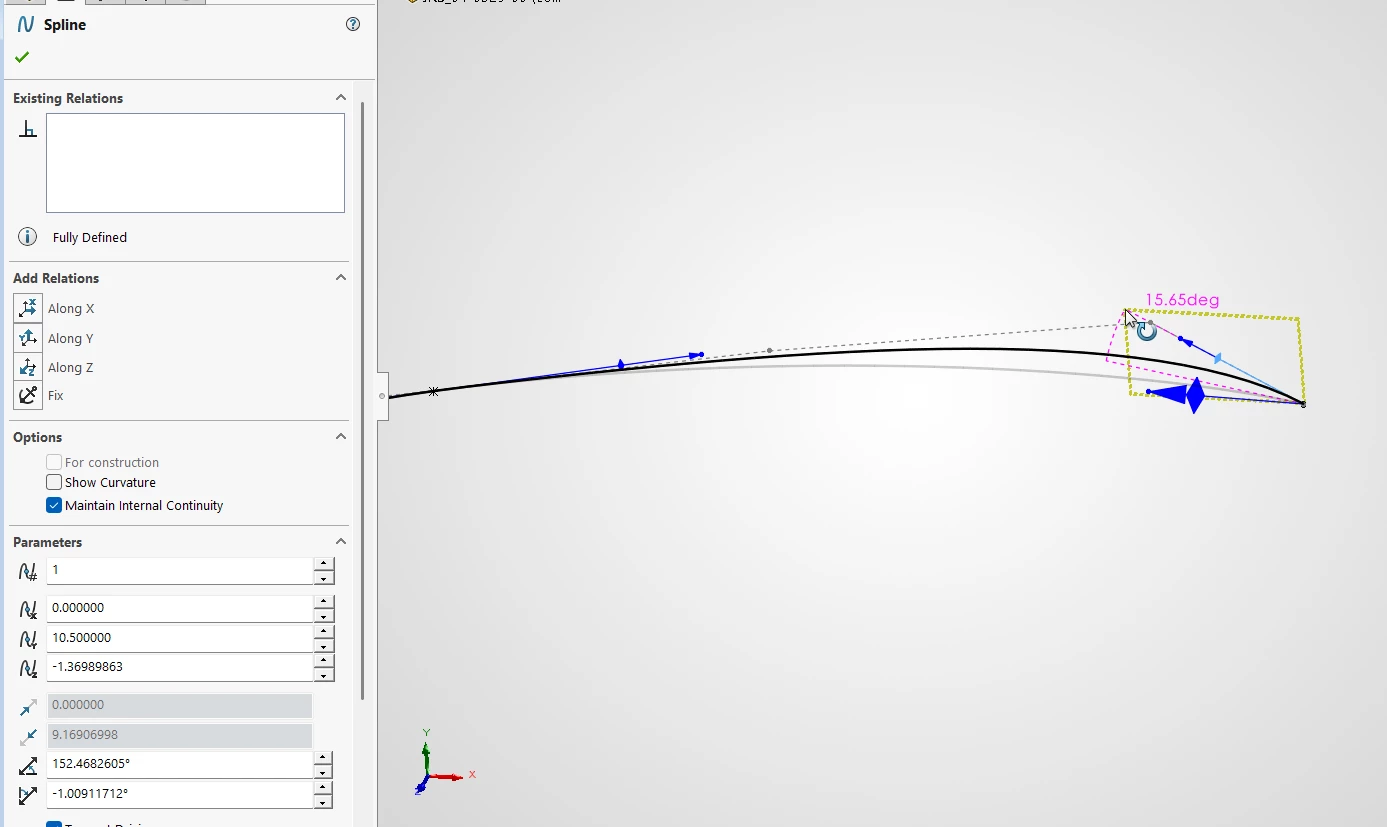

Is there a way in Creo Parametric to adjust splines with drag handles, like in Solidworks?
I am trying to replicate a part from Solidworks, but I cant get the splines to behave just like in the Solidworks part. I’ve noticed that in the Solidworks feature the splines have ben drawn by draging the lines to the desired position.

Double click on the spline and you will enter the spline tool.  The first button will get you what I believe you are looking for.
AlexK15-MoonstoneAuthor
Apr 23, 2026 1:58 PM UTC
Hi Kdirth
Thanks for your reply. I can’t see any options to adjust the spline, exept for the four predefined start and end conditions.

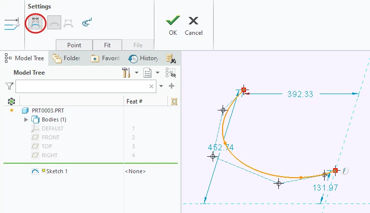

I think the trouble is you are talking about a 3D spline, created through points, whereas the image showing control points that can be manipulated is for a spline within a 2D sketch.I don’t know if the functionality for moving around control points is possible in Creo. Maybe in a design module like advanced surfacing or cabling or something I don’t have?

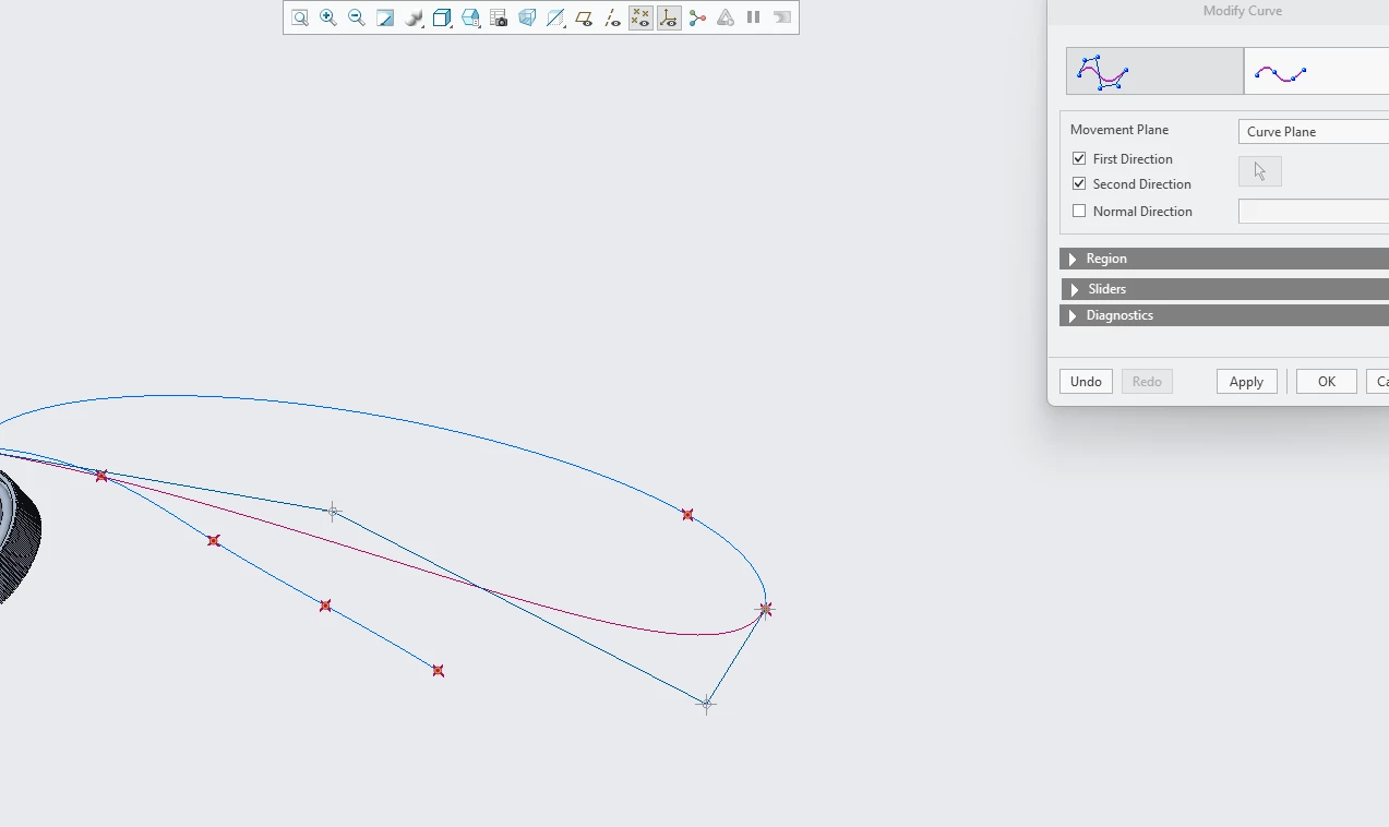

Create Curve1 from PNT1 to PNT2 / Redefine / Play with options / Tweak curve / See Image attached: Hope this is close to what you need. Create Curve2 from PNT2 to PNT3 / Redefine   / now play with Tangency and tweak. / *[ Tweak option will not activate for curves with multiple points]

For a 3D curve through points, option Tweak curve is only available with 2 points.  The Style license will allow some more control on a style curve.
