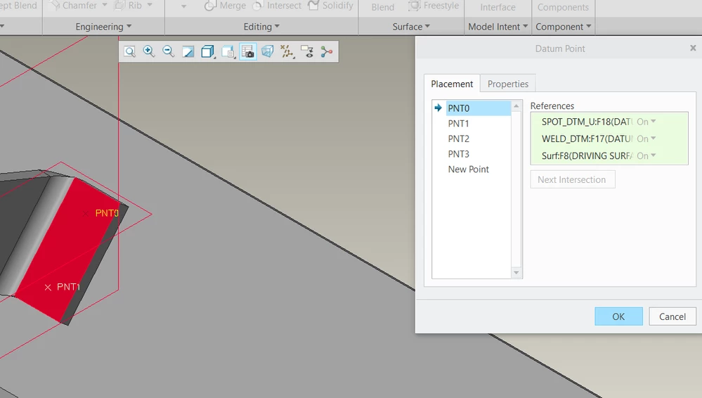

February 16, 2021
I am having this same issue with Creo 5.0.5.
My datum point has been created in an assembly by intersecting two datum planes and an outer (top) surface of the weld. The two faces being welded together are coincident to one another.
What am I doing wrong?

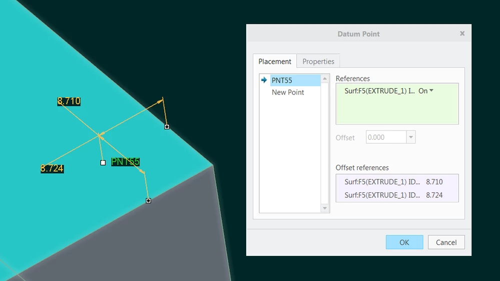

I don't use the weld module.  However, from the other messages in this thread, It sounds like the datum point has to be "on surface" for it to be usable for the spot-weld feature.  Can you show the screenshot of how this point feature is defined?
I have a feeling that you have to have the point defined with this scheme (on surface, with 2 offset references):
February 18, 2021
The point is defined as the intersection of 2 datum planes and the surface on which the weld is to occur.
It is defined within the part in the attached image, but I have also defined it in the assembly itself and that did not change anything. I have also attempted defining each spot weld point as it's own point (in the model tree), rather than a point within a grouping with other points. This also did not change the behavior.
