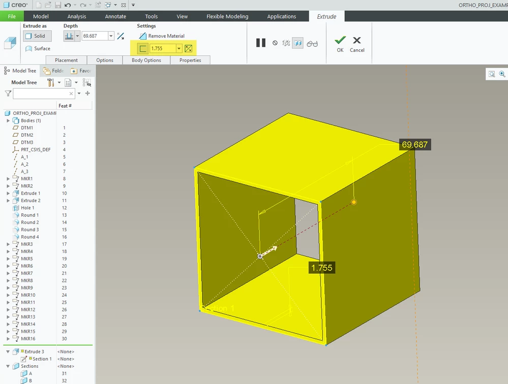

It's been a while since I have done modeling in CREO.  What's the best way to model square tubing?  I thought there used to be a feature that you could extrude a line with a thickness to get simple square tube.  I am just trying to sketch up a simple weldment bracket, and I don't want to put a lot of time into the modeling.  It's not necessary.
Thanks in advance.

Extrude a thin protrusion is what you are looking for.

Bingo!  That's it.  Thank you.
Feb 27, 2023 2:19 PM UTC
You can use the Framework extension to get your tube size and length against a single line.
