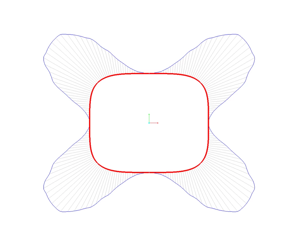

Apr 4, 2023 11:33 AM UTC
I would evaluate the math on this as Creo represents the curves if you plan to use this as a cam profile. The curvature plot does not look right to me when using the Cartesian parametric representation of a superellipse configured to form a squircle shown in red.
