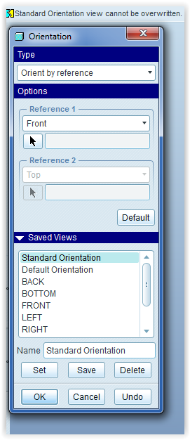

How do I change the Standard Orientation in a Pro-E Part? I can change all the orientations except Standard Orientation

Hi Antonius,
I tried with this option but it wasn't helpful. Let me reiterate. I want to save the standard orientation at a specific angle. I oriented the part and selected save on Standard Orientation it's not letting me to overwriteScreen+Shot+06-16-14+at+03.52+PM.PNG

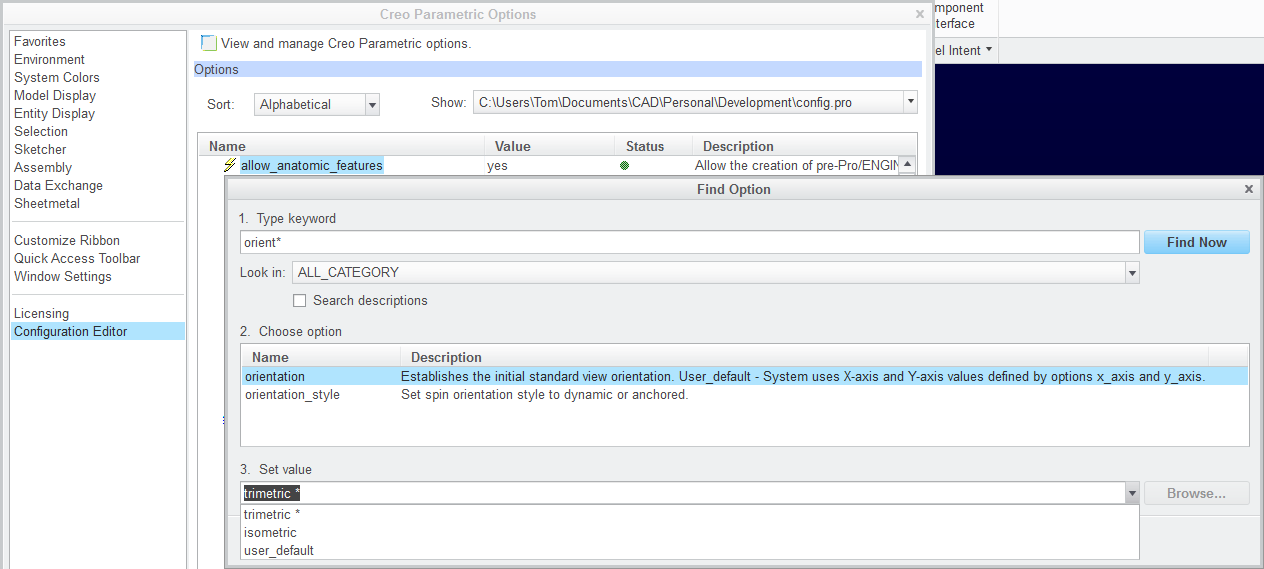

July 3, 2014
The Standard Orientation can either changed as Isometric or Trimetric, How did I change to an certain angle.
July 3, 2014
The "user default" option allows screen x and y rotation settings as well as ISOMETRIC and TRIMETRIC options.  See my image above.
