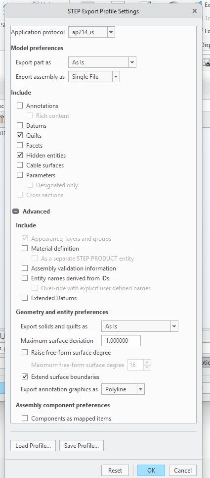

STEP 214 export with colors dont works
Creo Parametric 6.0.5.1
This is my settings. Orginal .JT have colors, but exported STEP dont have 😕

If you have not yet done so, please test with these settings documented in the link.
Article - CS22317 - How to export part or assemblies as STEP with color information from Creo Parametric
