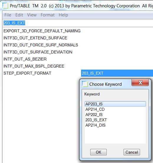

May 13, 2013 7:04 PM UTC
These are the step options of Creo 2.0 M040
ptc-201971-VisitorAuthor
May 13, 2013 7:42 PM UTC
Thanks. I did check the config.pro options and did not see AP242 as a value for the "step_export_format"
Other major CAD systems, such as Catia V5 R6 seem to support AP242.
Does anyone know what PTC's plans are for this? Creo 3.0? Creo 4.0?
