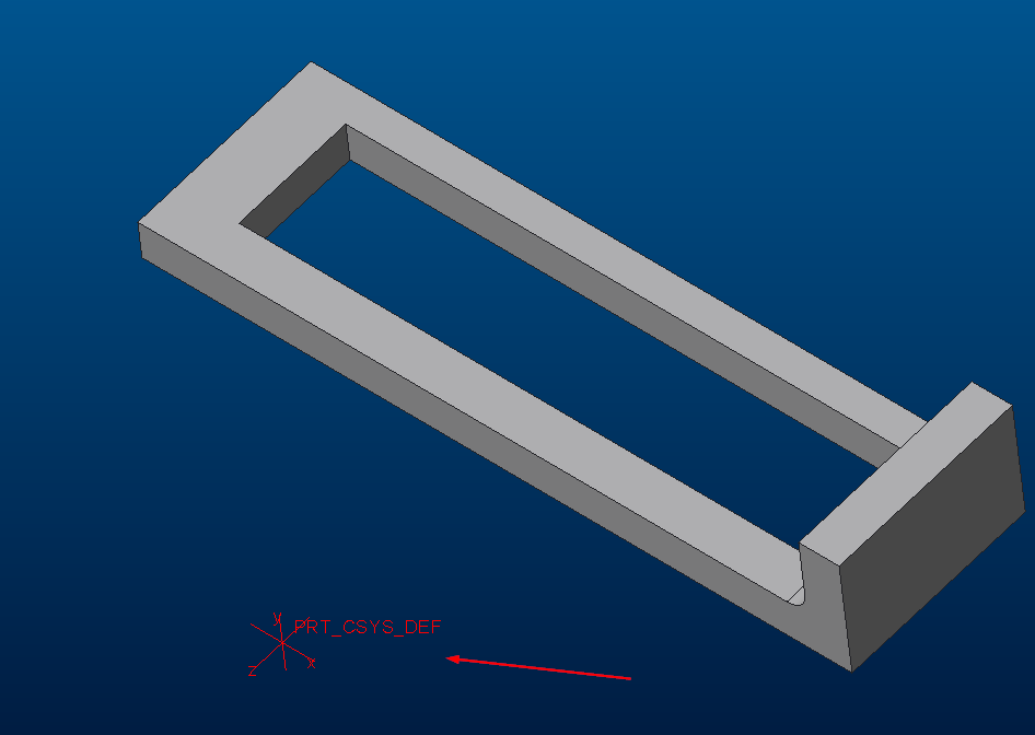

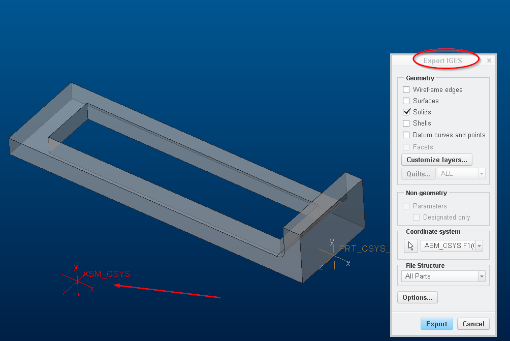

In assembly environment, If I export some parts by a specific assembly UCS in Iges format the output is correct. All generated files have the ucs I chosen.

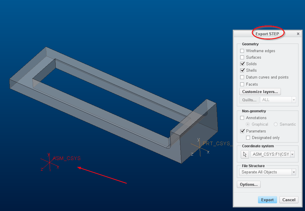

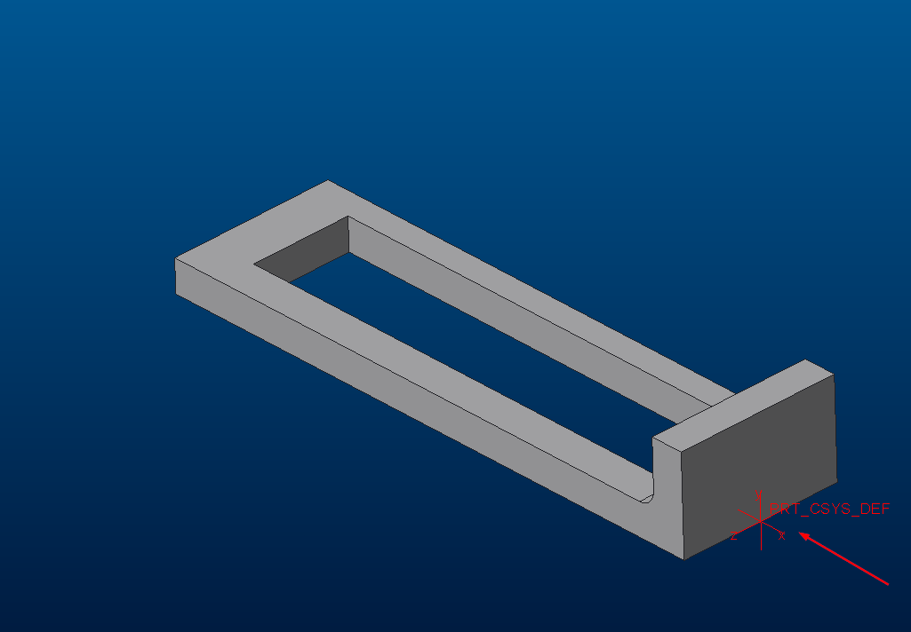

This does not happen in Step format. The parts always mantain original part UCS.
This is a big problem to us because we always export parts by project ucs and not part ucs.

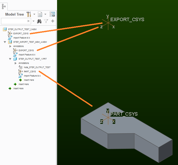

Exporting an assembly to STEP using a non-default coordinate system, then importing it back will result in typical mess:
I don't get why Creo always makes an assembly of an assembly when importing step data, but anyway, the problem for you is that the PART_CSYS is still in its original place, but you'd like for it to be where EXPORT_CSYS is located...
So I don't have an answer, other than pointing out that the export works as you expect if you do it from part mode...
