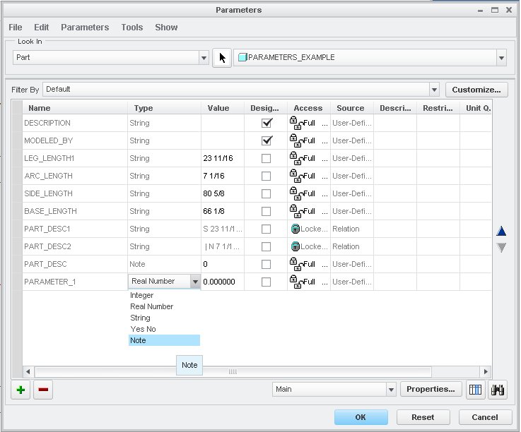

Does anyone know if there is a length(charactor) limit to a string parameter? We have some parts that get notched at various places and I'm trying to drive the part descreption with relations so they dont have to be entered manually every time.
My relations end up looking like this to drive the parameter.
PART_DESC1 = "S " + LEG_LENGTH1 + " | N " + ARC_LENGTH + " | S " + SIDE_LENGTH + " | N " + ARC_LENGTH + " | S " + BASE_LENGTH
PART_DESC2 = " | N " + ARC_LENGTH + " | S " + SIDE_LENGTH + " | N " + ARC_LENGTH + " | S" + LEG_LENGTH1
PART_DESC = PART_DESC1 + PART_DESC2
I had to use 2 parameters because the relations won't except a single equation long enough to populate the entire description.
This is what the the final value for PART_DESC should be
S 23 11/16 | N 7 1/16 | S 80 5/8 | N 7 1/16 | S 66 1/8 | N 7 1/16 | S 80 5/8 | N 7 1/16 | S23 11/16
but all I get is this
Its cutting off the end so I'm wondering if there is a length limet to the string parameter. I haven't been able to find anything specifying a limit.
I know I could remove some spaces, but I'm hoping I won't have to do that.
Any help is appreciated.

The string parameter is limited to 80 characters.
One possible solution to your issue is to define the PART_DESC parameter as a note type parameter and to associate a note that show the entire text.
In the attached example PART_DESC is reading note_0 from the part.
Hope it helps.

Ok, that brings me to another question, "note" is not an options for a parameter for me. How do I define a parameter as a note?
I'm using Creo 2.0 M040
July 11, 2014
You can only do this when you create the parameter. Once a parameter is defined you can't change the type anymore. Take a look at the attached picture. If you don't have the note option on the list than something is really strange.
