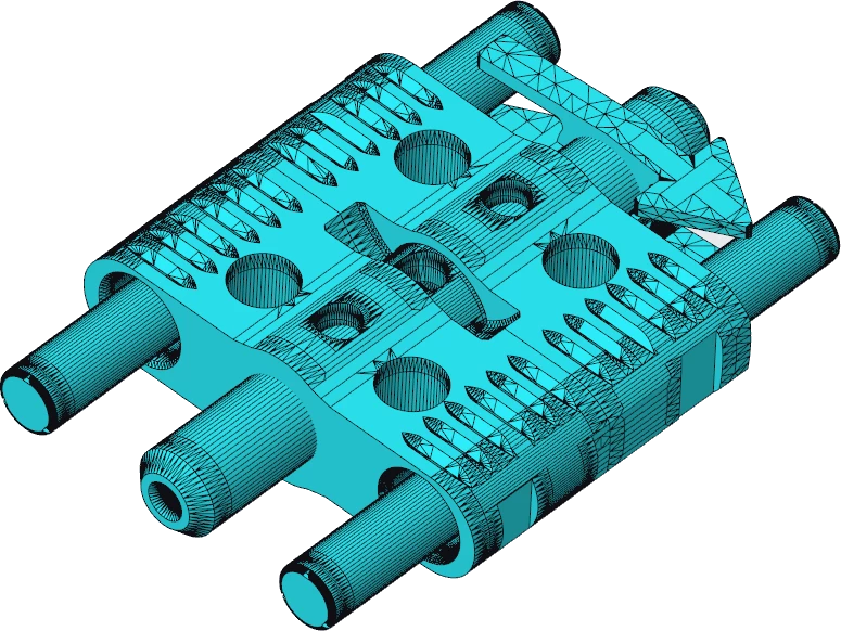

Please see attached Creo 8 file
KenFarley
Feb 11, 2025 6:06 PM UTC
Any solid model created from an STL file is going to be a faceted approximation of the "real" part. If you're just using it to check clearances, or to maybe make a 3D plastic prototype, that's probably okay. If you want an actual model that has "nice" surfaces you have other options like
(a) Read in the STL file and use its geometry as a guide to build a proper solid model. Not fun, but it'll probably suffice, depending on how precise the surfaces of the model need to be.
(b) Contact Dentaurum or whoever and see if they will provide you a model. Not likely, this is something they sell and they probably already have trouble with counterfeiters (everyone does).
(c) Buy one and measure it to build your own model - I've done this when I needed to modify a "stock" part for my needs.

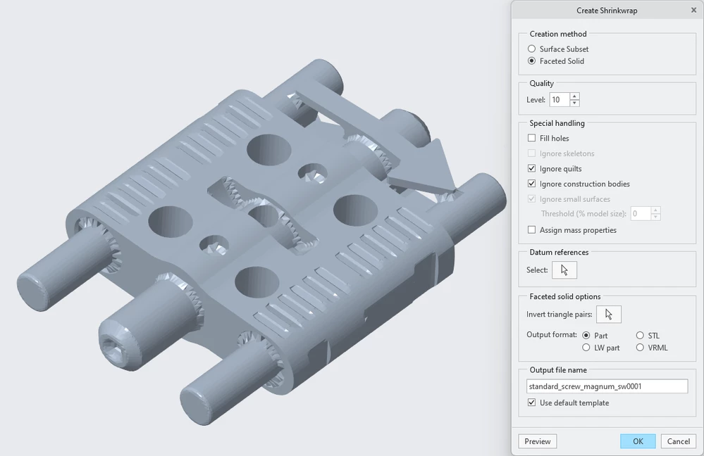

Hi @aminhas
I exported to Shrinkwrap using the settings shown in the screenshot.
It isn't high quality, but it's the best Shrinkwrap can provide.
aminhas14-AlexandriteAuthor
Feb 13, 2025 2:54 PM UTC
Can we enhance the quality even further?
Feb 16, 2025 7:35 AM UTC
Unfortunately not. I used the highest possible quality level.
