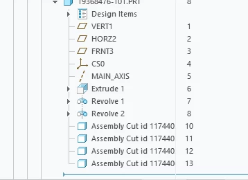

Sep 23, 2026 4:42 PM UTC
If you expand the part in the assembly to see the features, assembly features will look like this in the part .
It is not unusual if someone creates and assembly cut and allows creo to “automatically detect” intersected part for parts that are not actually affected to be included in the assembly feature. If so, you will need to edit the assembly feature and un-select “automatic” on the intersection tab and remove the part(s) that are not supposed to be affected.
