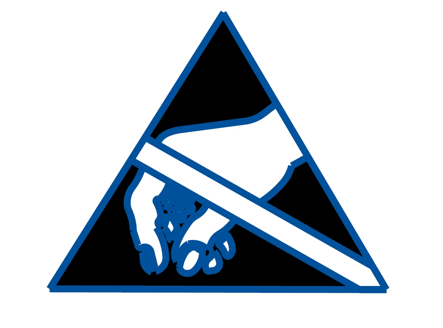

When saving a 2D drawing as PDF, how do we stop the stroke lines around symbols, etc?
This is how it looks in Creo.
When saved PDF, this is how it looks:

In the config file, set the ‘pen_table_file’ option to point to the pnt-file containing the print pen settings.
In the pnt-file, specify the minimum thickness for pen 1. For example: pen 1 thickness 0.001 cm
In the PDF export settings, enable 'use pentable'.

thank you! it worked like magic.
