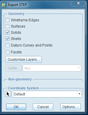

January 28, 2015
In Creo 2 there is an option to save the assembly as a single file during the exoprt to STEP process.
cdown1-VisitorAuthor
February 16, 2015
Hi where is this option found?
cheers
February 16, 2015
Creo 3 – File, Save As, Save A Copy, change type to STP.
Dale_Rosema
June 22, 2015
So it is not in the versions below Creo 3?
