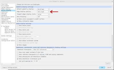

I'm kind of remembering getting oddball results with large arcs in the past. They'd get faceted and look goofy. Maybe it's too simple a guess but how about the setting shown in the attached image?
Since you said you have many other parts with the same type of geometry and they're fine, I doubt my answer is right, but there it is anyway.
Aug 22, 2022 12:17 PM UTC
Hi Ken, that was the first thing I checked. I have edge display quality set to 'very high' in my config.
