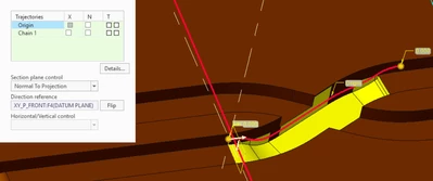

I have a problem with identifying what is wrong with the Intersection paths for Sweep:
It seems like an easy fix but I need some fresh eyes to catch it.

I opened it in Creo+ and chain 1 is an edge on the bottom of the board.  You must have accidentally selected it.  I changed it to the curve and the result looked better.

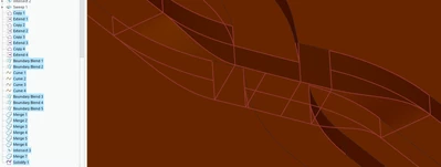

I also tried creating a similar feature with surfaces
  • Copy and extend walls
  • Add curves for transitions
  • Create boundary blends to fill in surfaces
  • Merge all together.
  • Solidify - remove material

Thanks a million @kdirth, the previous one is my preferred way. It works fine now, thanks!
