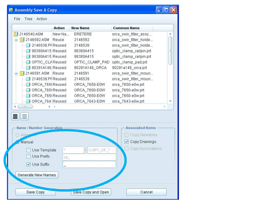

  • You can also specify a mapping template DURING the "Save a Copy" command through the tool that pops up. This is the best way to go. The WF5 version of this tool also features a "Suffix" command to automatically append characters at the end of files during the copy operation. The Save a Copy screen is shown below. You'll need to enter a name for your top level assembly first... but then this window will appear...

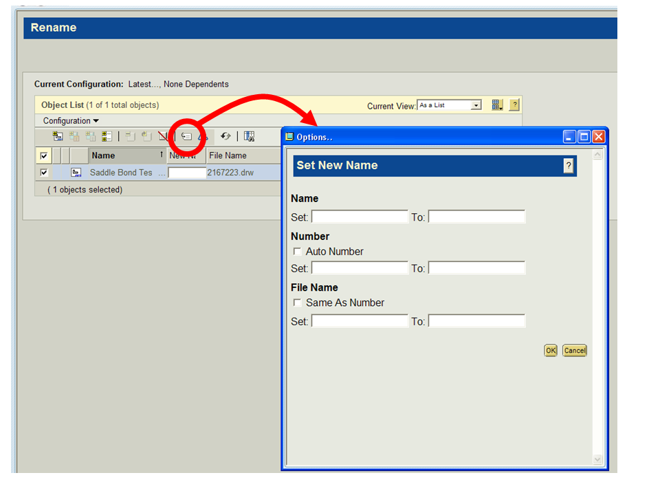

  • Finally, through Windchill or Pro/INTRALINK you can rename multiple objects at the same time using the "Set Name" function. A small tool will open that allows you to specify a "From" and "To" mapping template. The Rename tool and the icon to access the Set New Name function appear in the image below...
In all cases, you specify a template mapping by setting a From and To value. The From value is typically something like "*.*" The asterisk wildcard matches everything so "*.*" essentially matches everything. The To value would incorporate your suffix. A typical To value might be "*_new.*" This would append "_new" to every file matched by the template.

Sure... you can just do a Save As using the template command to rename everything with a suffix added. The template could be from "*.*" to "*-suffix.*" That would save a copy renaming everything to the old name with a dash and the suffix you specified.
If you don't want to save a copy, you can always perform a rename through Pro/INTRALINK or Windchill using the "Set Name" feature which also has a template style rename ability.
If you're not using Pro/INTRALINK... I'd suggest the "Save As" technique. Otherwise, the Intralink/Windchill method is easiest and safest.
