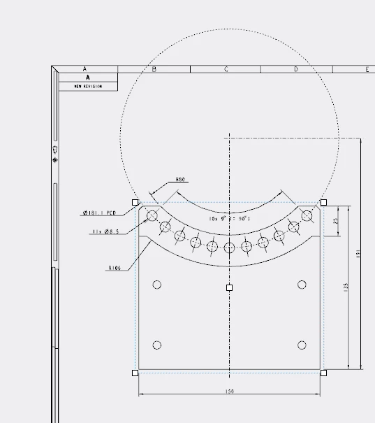

Is it possible to trim a radial axis pattern centerline ina drawing? ie: A bolt hole pattern centerline?

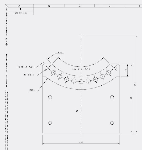

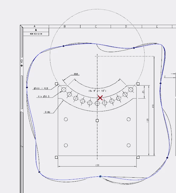

Solution: Turn view into a partial view and cut off the excess centerline with view spline. So easy I couldn't see it staring me in the face. Thanks to all who replied so quickly. Wayne, I agree this isn't a preferred method, but for these parts which are made in house, it will work. Thanks!

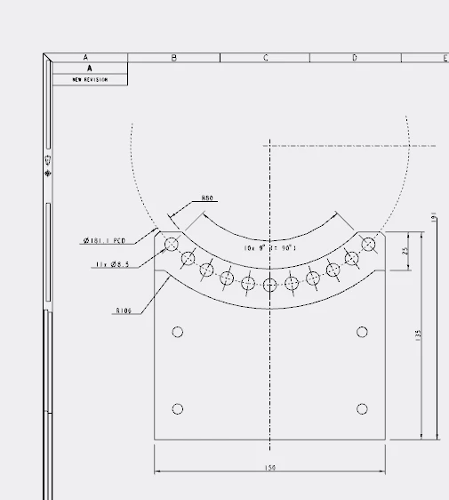

Sep 24, 2026 4:31 PM UTC
I tried this but the dimension to the centrepoint then messes up. It would also be great if this dimension could be foreshortened for when the centrepoint is way off the page.
This is on Creo 10.0.10.0
Sep 24, 2026 4:43 PM UTC
Fix: I had to right click the dimension > show witness lines
Not sure why this was needed.

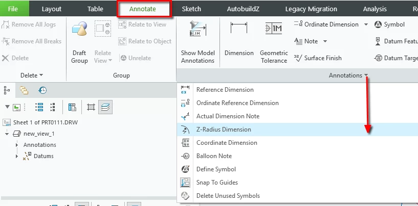

Oct 1, 2026 10:42 AM UTC
Try the Z-Radius dimension if it suits the requirement. In which case there is no need to clip the view.
