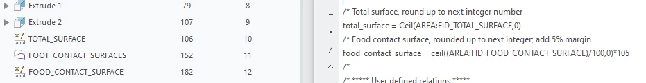

We are developing home appliances for food preparation. For regulatory reasons we need to provide the total surface and the surface in contact with food.
For a part I created feature measuring the area of the body to get the Total Surface. The I created a copy surface feature and again a feature stating the area of these copy surfaces. Using relations I created parameters which then are used in annotations. So far so good.
For convenience reason I tried to add this features, relations and parameters to our start part. Unfortunately the measuring and copy surface features fail if no geometry exists in the start part. I wonder if there is an option to add these features differently. Any hints?
Cheers, ziegi

May 25, 2022 2:13 PM UTC
So you want to have a start part that has a measure of a surface area of a copied surface that hasn't yet been defined (source does not yet exist)?
I am not seeing how that would work - without at some point, having to define the references of this copy feature so that actual geometry is measured.
One way, would be just to have a start part with the failed features suppressed.  Then once the geometry is there, resume them and then edit the references of the copy feature...
Or, why not just keep a "demo" cube in your start part, design your part, edit the references of the copy feature and then delete the cube?
I also recommend that you read up the help on user-defined-features (UDFs) and maybe also annotation elements and see if those would work for you.

Ziegi12-AmethystAuthor
May 25, 2022 2:27 PM UTC
You got the challenge. I will have a look at UDFs and annotation elements. I'm not in favour of the other options, as they will confuse co-workers using the start model.
May 25, 2022 2:44 PM UTC
Either way, you will have to explain to the end user what to do.  And to clarify, the UDF I had in mind simply had the 2 analysis features and the annotation feature & its elements.  The body and the copied surface would be created before bringing in the UDF group.
