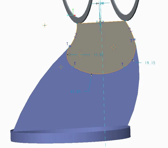

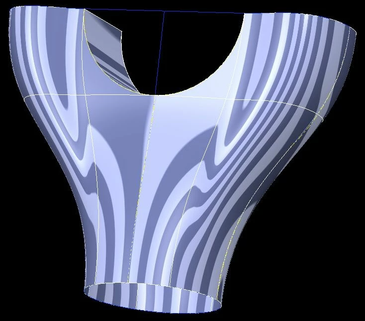

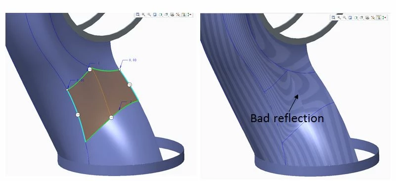

When creating a tangent surface, a bad reflection (compound) is obtained, see picture1
Please tell me how I would do it better, what would be the best reflection and smooth connection of surfaces. With the subsequent use of thickening.

You have bad control over your boundary conditions all over the place.  The less separate surfaces the better.  You could probably do all that with a single surface.

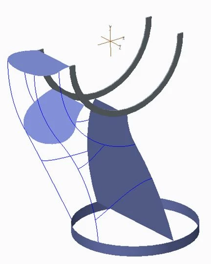

I have 3 sections and frame curves details. First, I create a surface on the two upper sections, then a side surface from the bottom ring and then a front surface (pic.3) ... there are just problems.
Please clarify what you mean by one to make one surface?

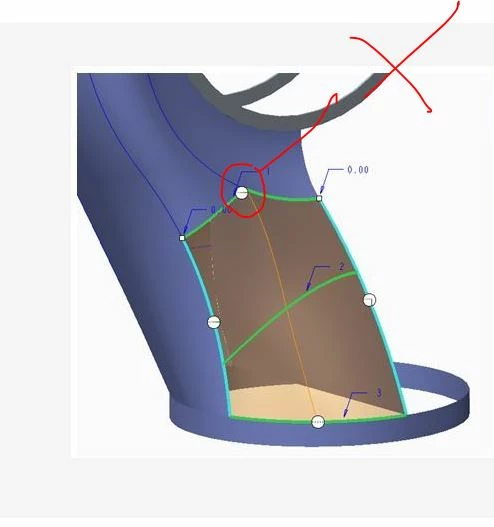

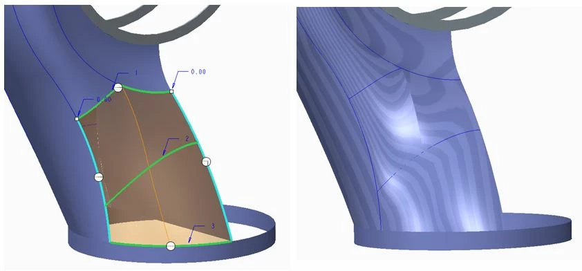

Are you using Boundary Blend tool to create this surface? Maybe the Style tool? If so, you are never going to get a nice surface given the boundaries you are trying to work with. I have highlighted the problem area in your screen shot, see attached file. You need to get rid of that corner somehow. If you are absolutely stuck with this geometry then the N-sided patch tool might work here, but i warn you in advance, its difficult to work with if you don't fully understand the tool. If you look in the help files there is an example of the N-sided patch tool showing a surface not too dissimilar to yours.
Good luck!
John
