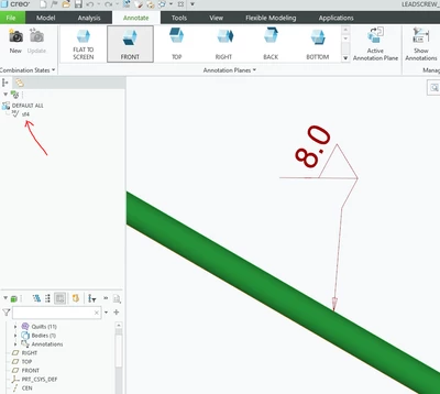

I am trying to place a surface finish symbol on a drawings and the message box at the bottom says,
"The selected surface is already consumed by surface finish sf0 as a restricted reference. Select another surface"
Where would I find sf0, and how did it get consumed?
StephenW
Nov 9, 2023 5:00 PM UTC
You should be able to see them in the model tree if you turn on annotations or in the drawing tree if you are in a drawing.
Dale_Rosema
Nov 9, 2023 5:43 PM UTC
I found it. Didn't know that it made a feature. I am used to dumb symbols that were put on drawings.

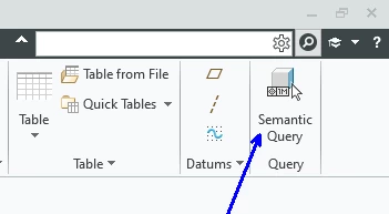

to resolve this follow the steps
1. open the model.
2. go to annotate

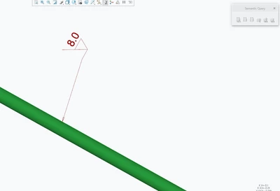

3.go to Semantic Query.
4.and select the surface it will be highlighted along with annotate.

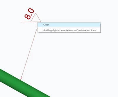

5. select the annotate and right click. clear it
6. save the model and go the drawing sheet it will remove.

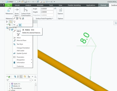

Aug 3, 2024 9:30 AM UTC
7. added "Add Highlighted annotate to Combination state"
8. select and delete it and save the model. go back to drawing it will resolve
