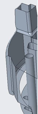

I have a problem to visualization some surfaces.
When opening an assy or only the part some faces are not  showed correctly.
The problem is not in all parts and assy that I have. In other files with similar assy them are showed ok.
faces like trasnparency.

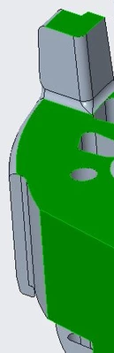

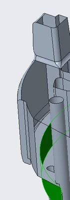

see faces selected with problem
If I make a section view, I see the solid not surfaces.
Well, I hope any help.
Regards.

Hi, thanks for your help.
Are you using a PTC certified hardware configuration?
No, I have Dell but with Intel Graphic.
Anyway

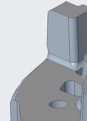

Do to you comments, I have started to review the option.
So... when desactivating the "enable transparency" the faces have been displayed. They have a different colors though the material properties are the same in model.
To change color I had to reapply the generic material.
Well, really thanks for comments about it. Maybe it was too simple but, I don't understand why some faces displayed and other don't.
Thank you so much.
