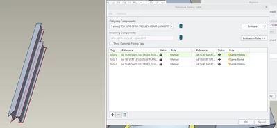

i've never used this before an im not sure what the evaluate table is telling me. i have 10 tags and 3 of then have yellow dots in the 1st ref column and then 2 have yellow dots in the 2nd ref column?
StephenW
September 11, 2020
Can you post a screenshot of the table?
something like this (as an example)
