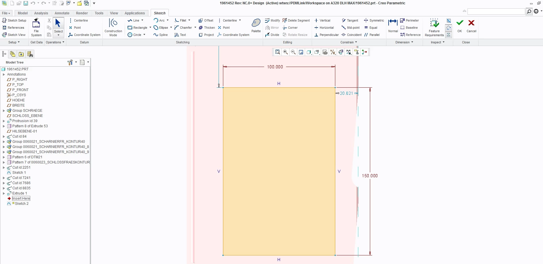

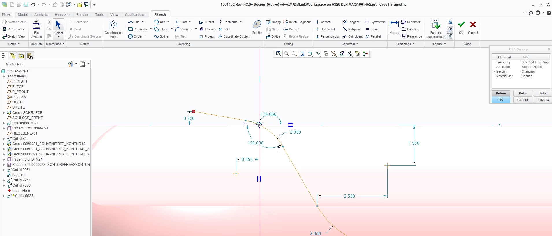

SWEEP CUT IN CREO 2
PLEASE TELL ME HOW TO SWEEP CUT IN CREO 2
CONDITION
OPEN SECTION &CLOSED TRAJECTORIES
FIND ATTACHED IMAGES
