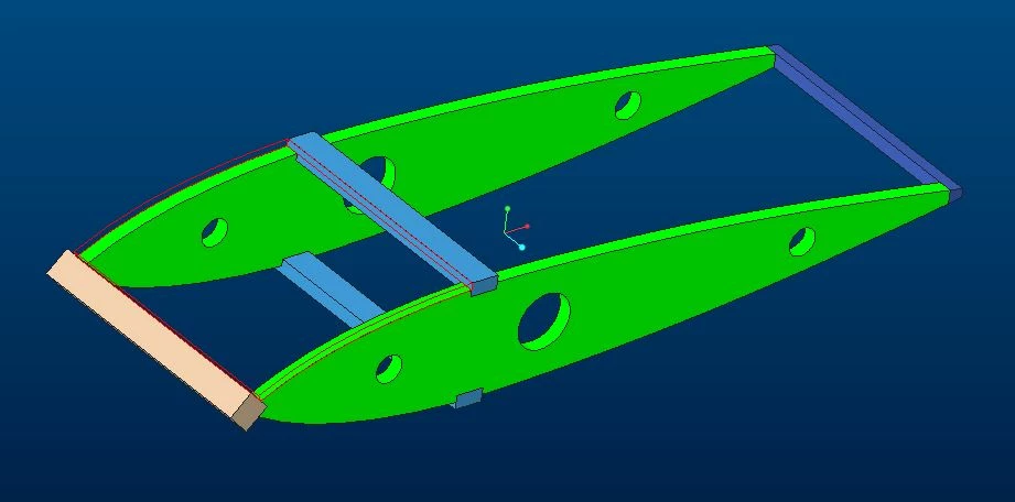

I have an assembly that has a wing profile with a duplicate 2 " offset from each other. I what to show sheeting going across one of the curves of the profile with a depth of 2". I use and edge as my curve for the sketch to follow. I have a "Green" check mark and after clicking on the "Green" check mark everything is okay except no solid feature swept. I thought maybe if I change it to a surface sweep but I get a notification about switching from solid to surface and then still nothing happens. tried changing thickness in the sketch but that did nothing. After accepting the check mark I get a red outline of what the feature looks like then after regen it vanishes. The Sweep feature is in the model tree and no failures or errors pop up.
