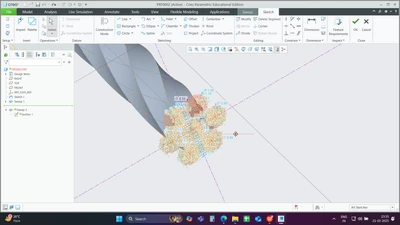

Sweeping error along a twisted hexagonal profile for making a wire rope
Hi, can someone help me with why I am getting a regenerating failed error when trying to sweep the wire cross section along the hexagonal twisted profile.

I don't believe the student version has any limitations that would cause an issue with a sweep.
Couple of things from looking at the image you posted
  • The circles of the sketch are not shaded indicating that they are touching, which will prevent extrusion
  • The original extrusion appears to be solid.  A surface would be more appropriate for what you are doing and running a sweep in and out of a solid can be problematic.
Also, download and open the file I posted that I mentioned above to see how I handled something similar.
Feb 21, 2025 7:23 PM UTC
Is there a tangency constraint between the individual strands?  Or do any of the circles touch or overlap?  If so, can you try adding a gap between the circles?

There is no tangency constraint and also enough gap provided

Without your model or trying to recreate it. I would say you are trying to do too much with one sweep.  I also don't know what you Sweep settings are.
Check out this discussion:  Creo Parametric Community Challenge 5 - Curves and... - PTC Community
My 4 twisted pair twisted inside jacket may be similar to what you are attempting.

Is it possible that I am using student version and that has some limitations.
