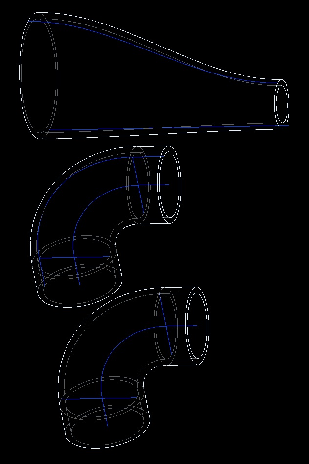

I have created an elbow as a swept blend. It starts out as a circle and ends up as a circle.
I'm apparently doing something wrong.
Again.
Please see the attached file.
The issue is that after the circles are blended, they are no longer circles but splines. I can't measure it in model space and can't dimension it in drawing space.
What am I doing wrong here?
Thanks.

Probably nothing. Sometimes geometry is promoted to a higher level of abstraction.
You might create sketched datum curves and create use-edge references in making the blend or add a sketched datum curve at each end that is anchored to the edge to give you something to dimension to.
You should still be able to show the arc dimension for the sketches on the drawing, but I can see where you might not be able to see the arcs that are in the sketch.

Works for me...
June 26, 2014
In your example I would do the cylinders at both ends of your tube using revolve or extrude and then blend only the section between them, selecting the resulting edges instead of sketching.
This I believe will also allow you to control the result better, as for example you will be able to add or remove tangency at either end.

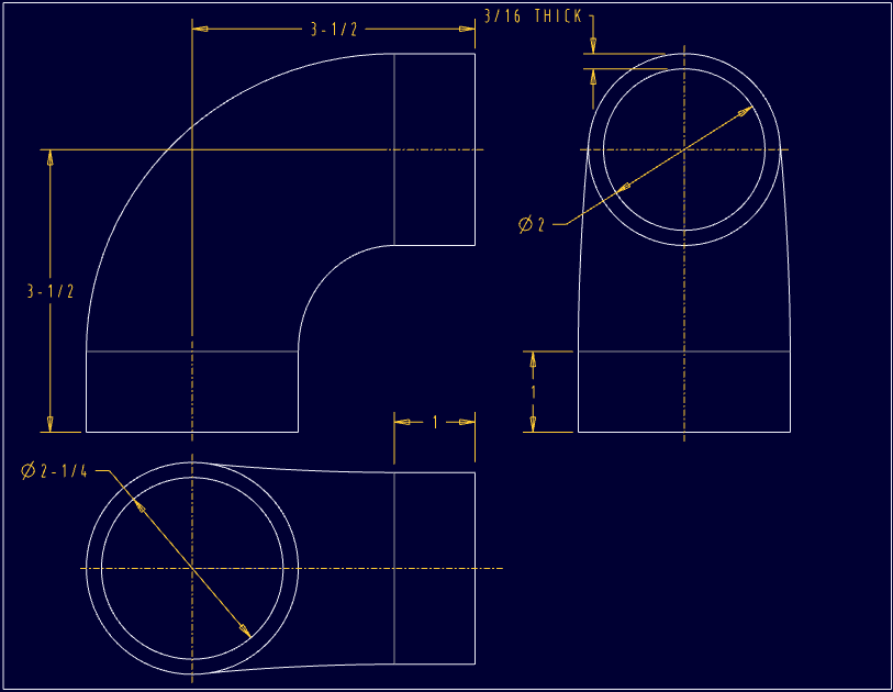

Yes, I can add those dimensions too. But mine don't come in as diameters and you've dimensioned to hidden lines!
Bad draftsman! Bad! <spritzes water>

You're not going to be able to measure (distance I assume?) on the blend because Pro/E doesn't know WHERE on that changing surface to measure, because you didn't tell it. In modeling mode you can query-select points on the surface. If you want dwg dims, put in a datum plane and use the interestion of that and the part to give you hard points to measure to.
An SPR is not needed, different/better technique is.
For this, honestly, I'd use a VSS, and in the curves defining the shape you can put geometry points wherever you want to measure to, AND the VSS will give you better control anyways and assure tangencies where you want 'em.

I want to look into the elbow, from both ends, and put a diameter dimension on the diameters. Shouldn't need to add planes. There is already a plane there - my sketch is drawn on one - the section is normal to the plane/sketch/trajectory.

A comparison for fun. The VSS is a little easier, I think, less sections to sketch, and you have more control over the geometry as well. What you can't do with a VSS is reverse curvature or switch between a straight line and curvature or vice versa.

In general, people that have used Pro|E for a long time and use driving dimensions throughout drawings have learned long ago that we create sketches and dimensions solely for using them in the drawing. Sketches may even be created to have a driven dimension available in the drawing but created in the model. What is more difficult is to consistently have the arc of the spine echoed in the drawing as a centerline so the radius dimension has something to point to.
As for the surfaces or edges of the blended feature not having primitive information available, that is something we long understood as a limitation. Somehow I defined it, so somehow I can access the data I entered.
There are some occasions that policy forbids use of driving dimension on drawings and that only driven drawing dimensions are allowed. Considering Pro|E was never intended to be used this way, means that the policy is not in line with the software (that never happens!). I have the luxury of making drawings however I see fit. And I find myself using both methods and still remain perfectly associative on the overall shape and size of the object I document. But I do often find myself changing the model to suit the need in the drawing. This could well be improved.

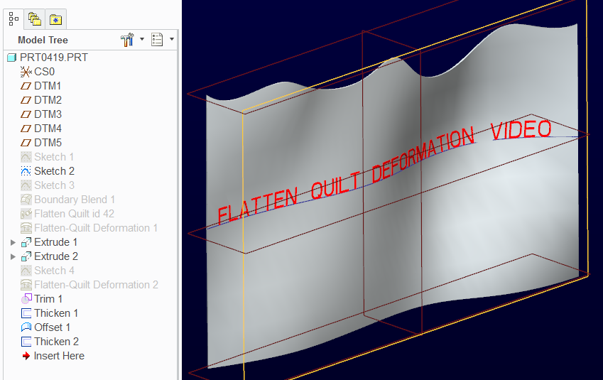

Just for the sake of completeness... and something new to learn...
If you have access (probably requires maintenance):
http://learningexchange.ptc.com/tutorial/3336/utilizing-solid-bend-and-flatten-quilt-functionality-in-creo-parametric
