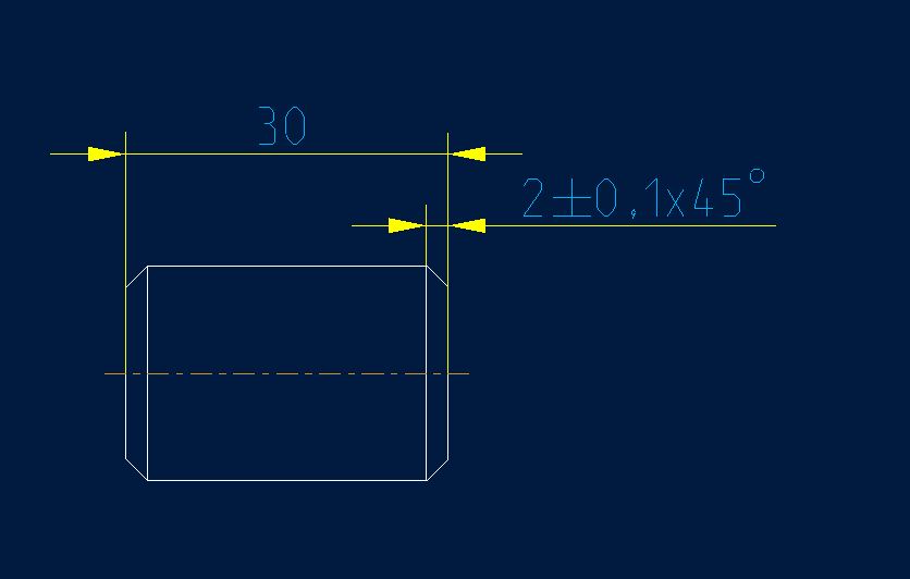

Hello Dear ProE Users,
does anybody have any posibility to switch the position of a shown chamfer dimension on a drawing from vertically to horizontally or vice versa?
Greeting from Germany
Jens

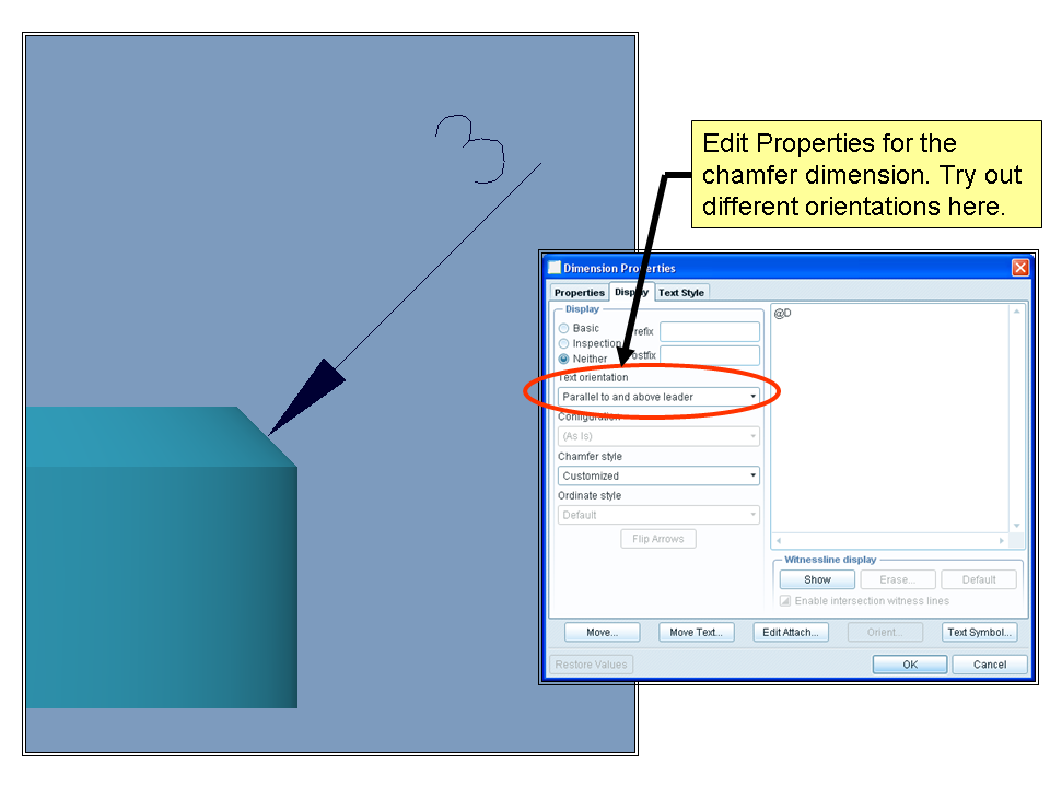

I wasn't able to get the dimension to be totally vertical. I tried numerous drawing options (File>Drawing Options) without much luck. However, by editing the dimension properties I was able to move the dimension parallel to the leader line which cleaned up the look a bit.
My suggestion would be to continue playing with the properties as shown below. Maybe one of the options gives you what you're after. Click the image below for a larger picture.

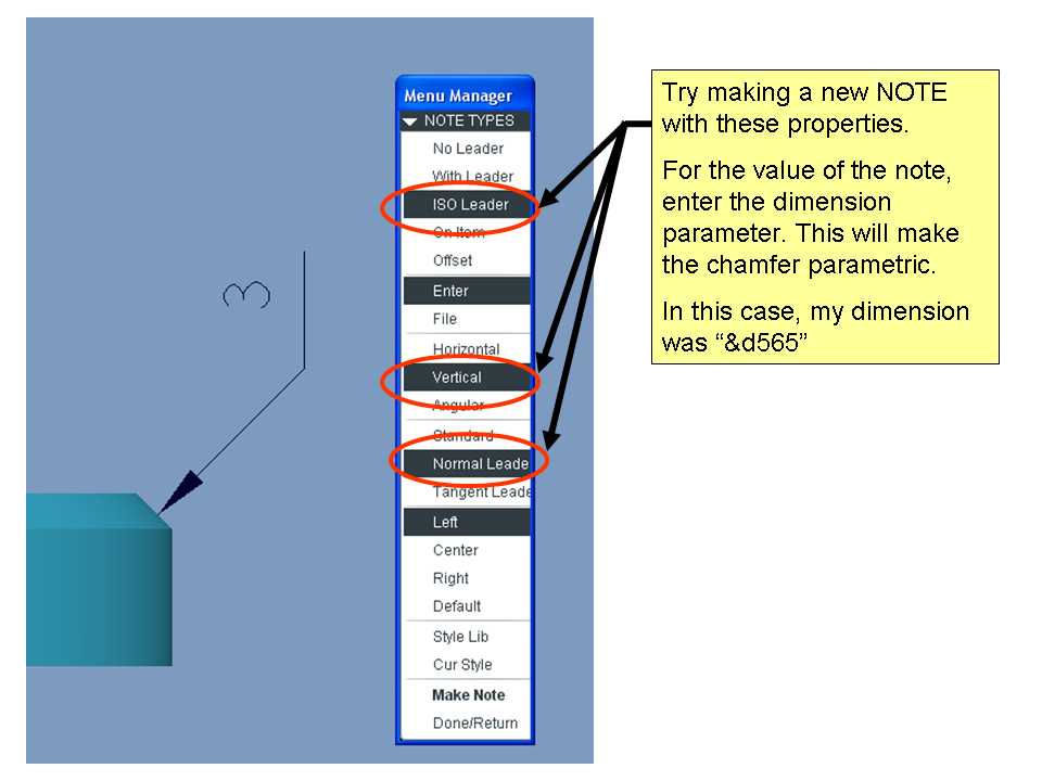

Of course... if you want to get a little creative, I was able to get a parametric chamfer note to be truly vertical... but I used a NOTE feature instead of a shown dimension. For the value of the dimension, I used the dimension name (the parametric dimension name). See the slide below...
Hope that helps!

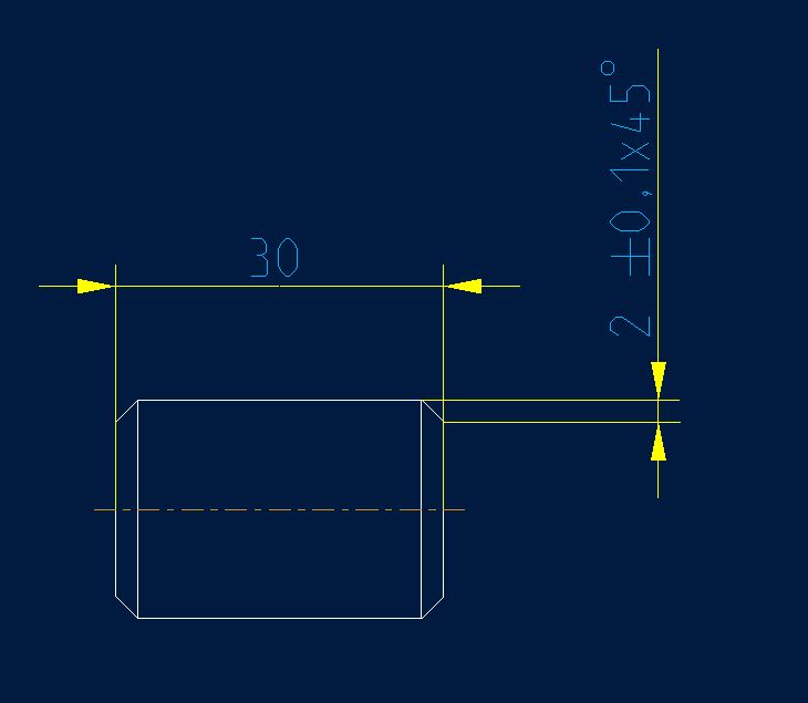

November 30, 2011
Dear Brian,
Thanks for your answer. But we here in Germany have to display the chamfer dimensioning as follows.
Here the dimension is in a horizontal position and we need it in a vertical position as follows.
The last picture was made by changing the dimensioning sceme to "Angle x D" and adding the 45° as a Note, but we want to have it out of the box, not modified with note.
Thanks - Jens
