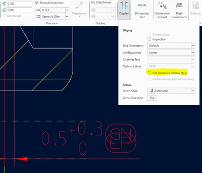

Symbols for asymmetrical tolerances E.g. ‘GN’ for upper limit and ‘LP’ for lower limit
I am using Creo Parametric Release 8.0 and Datecode8.0.11.0
According to ISO 14405 - 1, it should be possible to further specify both tolerance values with a symbol in the case of asymmetrical tolerancing. E.g. ‘GN’ for upper limit and ‘LP’ for lower limit. How can the symbols be assigned to the tolerance values in Creo?

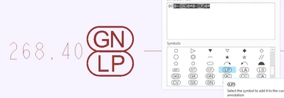

    6-Contributor
    Jan 23, 2025 2:29 PM UTC
    Here is an example of the symbols for ‘GN’ for upper limit and ‘LP’ for lower limit. How can I define them in creo?

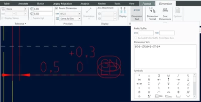

    kdirth
    Jan 23, 2025 2:58 PM UTC
    I don't know that you can add it to the format of the tolerance but you can add it to the dimension text.
    6-Contributor
    Jan 23, 2025 3:09 PM UTC
    Hey, thanks for your answer!!
    I have already tried this, but got the following result:
    If I deactivate the ISO display style, it is also wrong:
    do you have an idea?
