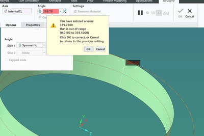

Symmetric revolve 359.75 degrees
I'm pretty sure I could do a symmetric revolve up to 359.9 degrees in previous versions of Creo.
Could someone let me know if that is true?
I am using Creo 8 right now and it's maxing out at 359.5.

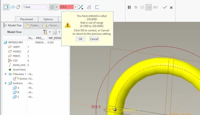

August 3, 2021
I'm on Creo 4 M130 and I max at 359.5.
SYNDAKIT15-MoonstoneAuthor
August 3, 2021
The reason this came up is because I thought I could do it before but when I just tried today it wouldn't let me.
I decided to grab some older models to see and yeah I could do 359.9.
Furthermore, I can copy that feature into other parts and it works okay, I just can't create a new revolve feature and rotate it symmetrically 359.9 degrees...... weird.
Here is the part I'm talking about:

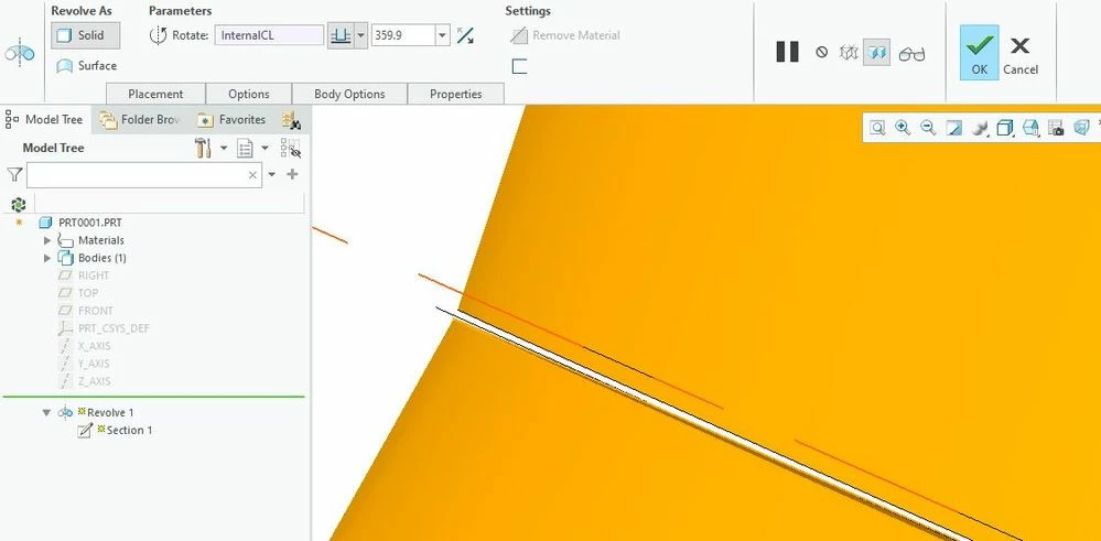

Chris3
August 3, 2021
Have you tried changing the accuracy?
Chris3
August 3, 2021
I can do 359.9
August 3, 2021
Change it to symmetric and let me know.

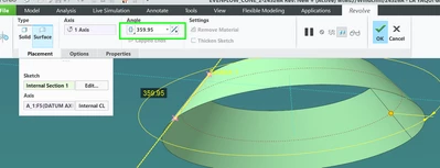

August 4, 2021
INFO:
In Creo 3.0 M190 I can create 359.99 symmetric revolve using PTC solid_part_mmks.prt template (attached)
In Creo 8.0.0.0 I can create 359.5 symmetric revolve (only) using  the same template.
Please ask PTC Support to explain Creo behavior.

StephenW
August 4, 2021
It's an odd thing, like it is hard-coded in as a limitation. It's not like a regen failure due to accuracy issues.
But I do think Frank is right, Creo doesn't like itty bitty slivers.
kdirth
August 4, 2021
The only thing I can offer is a work around.  Sketch an arc and use a sweep.  I have been able to create a 359.998 degree surface with this method.

Chris3
August 5, 2021
Sounds like one of those cases (I have run into a few) where the programmers were like well this is too complex of a math problem to solve so we are just going to make an arbitrary limit that we know will work.
