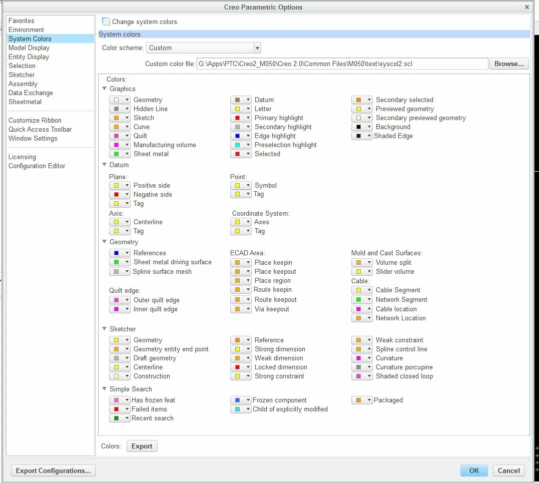

Having an issue getting customized system colors to load when I restart Pro/e
I go to ->File->Options->System Colors->Export
And I save it my Creo starting directory (same place as my custom config.pro). The custom color file never loads, I have to manually load it every time. What am I missing?

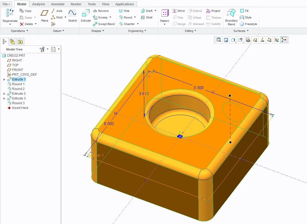

How could you even see yellow dimensions on a white screen? See attachment of how Creo2 comes up by default on my system.
I have one more question, what entity color is used for snap lines? They used to be a relative faint grey, visible but not in your face. Every color scheme I have tried they stand out more than the dimensions. There is no snap line entity in the system color dialog (at least I can't find it if it's there).

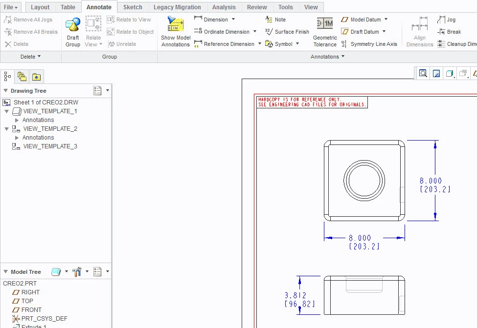

David,
There seems to be a problem with your setup. This is not the default that Creo uses.
Here are some screenshots of the model environment and the drawing environment. As you can see, the default dimension colors are blue and look just fine on the white background.

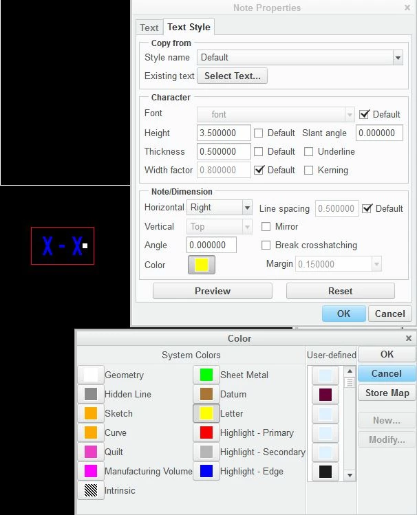

Yeah, something weird is going on. I tried updating the video driver, made no difference. I have loaded a syscol.scl file that looks better but still not great. Now the letter color is supposed to be yellow on a black background according the the syscol.scl and the text properties dialog. However, it is blue on the screen. I have no idea where to go with this. I'll have a new workstation in a month or so, I will probably see how it looks on that before I spend too much more time on it.

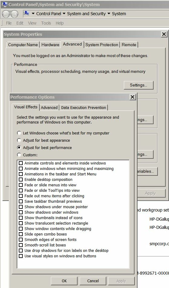

I'm getting the same behavior on tow different machines, they are differnt brands, have different processors and video cards so it got me to thinking maybe it has something to do with my Windows 7 settings. On both machines I have set the visual effects performance options (under advanced system properties in the Control Panel) to "Adjust for best performance". This gets rid of every Aero BS fade/slide/shadow/animate feature. Is this messing with Creo's colors? With WF4 this setting made all the difference between an unresponsive system and a snappy system, but maybe Creo wants some of the eye candy?

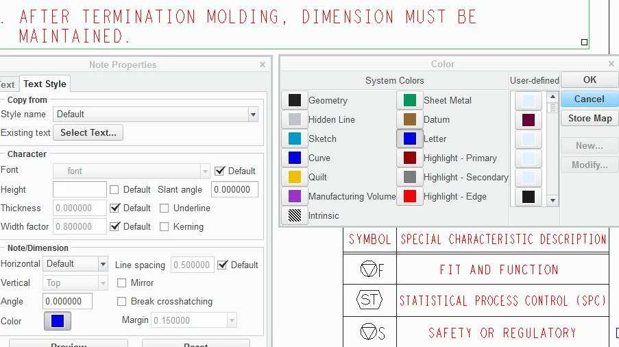

I enabled all the Windows Aero farkles and the default CREO2 system colors. Now I see blue dimensions and red note text like your attachement. However, I still get the bizzar behavior that when I click on a note and go to the text style, it it says it is system color "letter" & shows it BLUE but the text is RED.
