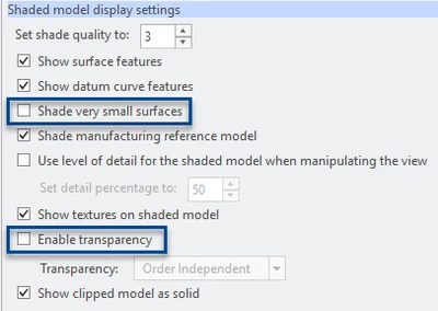

It sounds like you may be dealing with some pretty heavyweight data. Does your model contain any of the following?
  • Non-solid parts (quilts, surfaces)
  • Complex geometry (threaded fasteners, ball bearings, complex extrusion profiles)
  • Transparent components
  • Components with unnecessarily high level of detail
If you have components like this in your model, you may want to do a bit of simplification before exporting. Try suppressing/excluding the parts you suspect are complex and reexport. If you can get an export to work like that, you can narrow down your list of culprits. I'd recommend starting with the non-solid geometry.
To help get you started, try turning off these two settings before exporting. It should help a bit.
Ty
