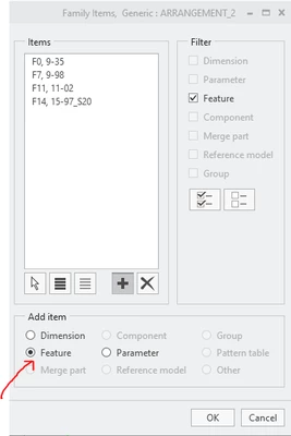

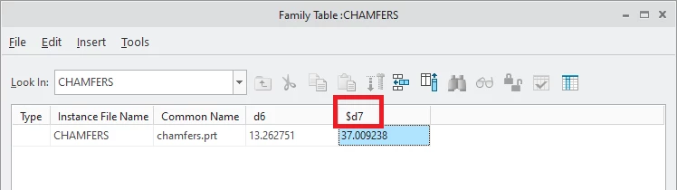

Hi Every one,
My requirement is to create an irregular pattern of holes. I have 'X' and 'Y' dimensions of points where holes to be made and will create a family table of patterns.

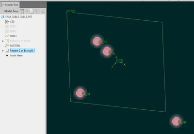

but, after creating table pattern the points are reversely plotted (-ve became positive and positive became -ve). I think it is taking relative position instead of absolute positions. I can reverse the signs to get the proper results but I have to use the exact values of 'X' and 'Y' dimensions.
I have attached the snaps of the problem I am facing. please help.

Yes, I believe you describe the table pattern behaviour correctly and I suppose it works according to specification that all pattern members will be re-arranged to adapt to the new "sense" of the leader instance dimensions.  I don't think there is a way of specifying that the table pattern instances will be located according to some "absolute" coordinate system.  (if you could suppress the 1st instance in a pattern, then the work-around could be to have the 1st point be in the 1st quadrant)

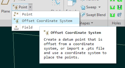

So I suggest using point-based patterns and specifying the points using sketches, or the "offset-coordinate-system":

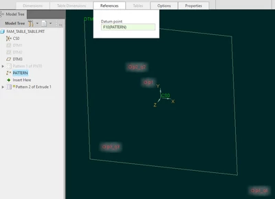

For example, define your point field:

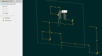

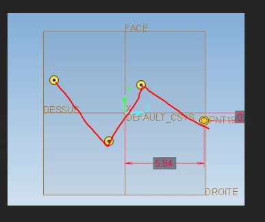

now editing the 1st point, you can specify its placement in the 2nd quadrant:
and the other points "stay in their place":

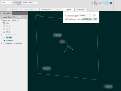

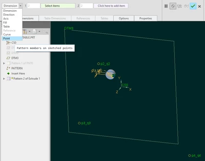

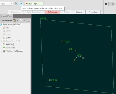

Then you pattern your feature by using "by point" method:

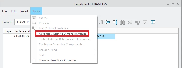

May 23, 2023 9:18 AM UTC
in Family Table you have to set absolute dimension values
May 24, 2023 3:13 AM UTC
Hi Martin,

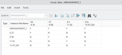

  • I have selected the family item item as feature so the absolute coordinate option is not available.

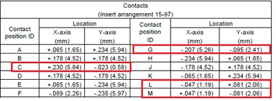

we have multiple hole arrangements in each size of part.
for example: Size 9 (S9) has 9 to 10 various type of hole arrangements.
                        S11 has again 8-9 different hole arrangements. this way we have total 9 sizes S9, S11, S13...…. S25.
and each size has different 8 to 9 hole arrangement.
  • so for these I am creating UDF under which I have defined the family table which shows instances of each size. each instance will have different arrangement of hole. please help....!
May 27, 2023 3:45 AM UTC
I was expecting the same thing. I will go with point method.
Thanks.
