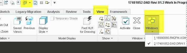

I have the "windows" icon in my quick selection toolbar. It is also under the view tab, Windows

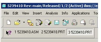

We were able to do them back in Wildfire 3.0 ad 4.0 and then they took away the command from the options menu. It was tabbed across the top of the window.
We have been asking them to bring it back since Wildfire 4.0. I showed it at a PTC Tech Committee meeting at PTC and they were surprised and didn't know that function was there.

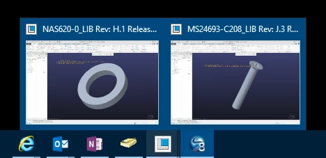

You can accomplish this via the normal windows taskbar and the config.pro option activate_window_automatically yes. I'm not sure PTC would put any effort forth in creating new tabs when the functionality is built into Windows itself. Regards, Dan N.

PTC improvements have always been about minimizing mouse travel. If you are moving your mouse around the top of the window between the different toolbars and icons, why not enable tabs like OneNote that shows each Section.
When we were able to do it back in WF3/WF4, the tab showed the name of each file open.In windows taskbar you still have to mouse over the taskbar, then over the creo icon to get the open Creo window icon to show, then pick the Creo icon to open.
It was much easier seeing every open window tabbed under the menu bar.
