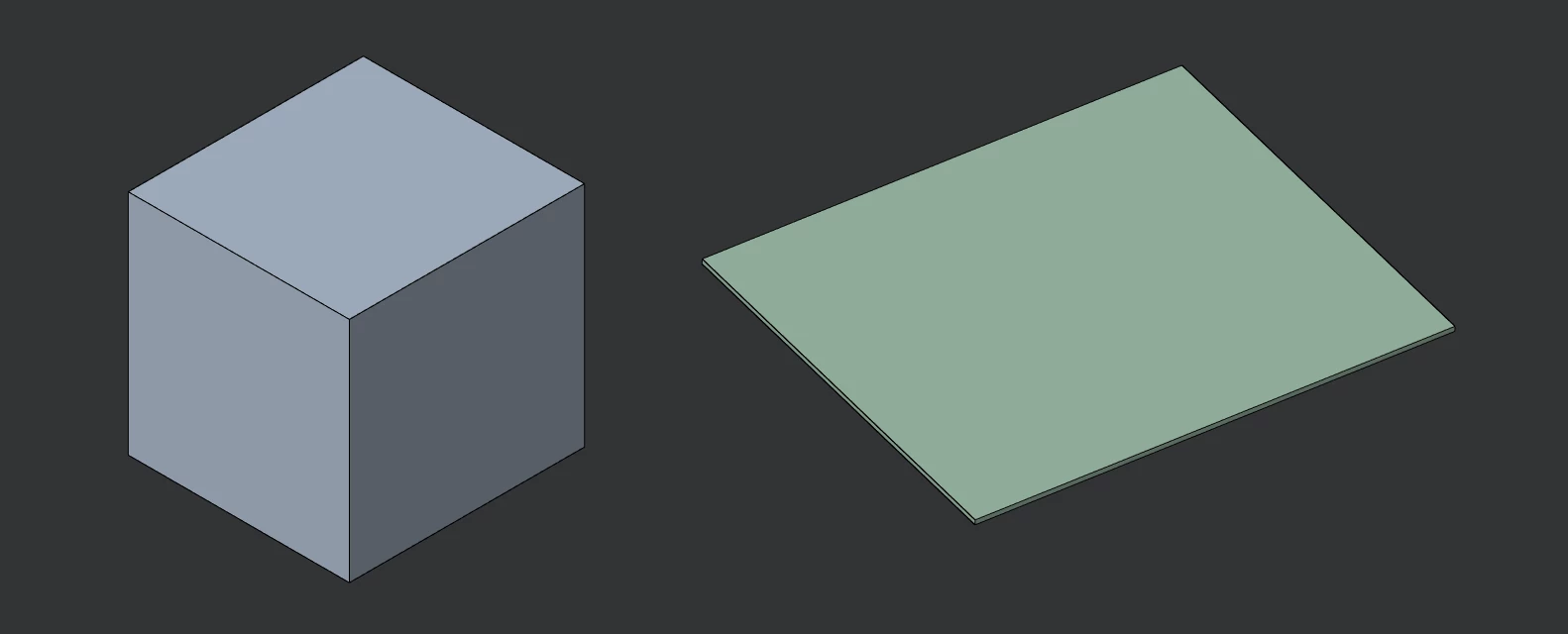

Hi, recently changed to Creo 10.0 and noticed that the "standard color" for start templates is not the usual grey anymore. Instead volume parts are kind of lilac, while sheetmetalparts are slighly green.
Is there anyway to change this back to the standard grey? I could of course color the templates now, but all of my older projects look lilac and green.

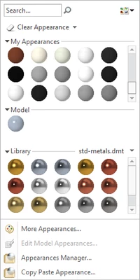

I have not used Creo 10 yet, perhaps something has changed with the color maps in appearances. You can of course export the .dmt file from a previous build and import that as well.
If you want to experiment with a custom DMT based on RAL color references, take a look at the one enclosed. There are multiple choices for "grey" available.

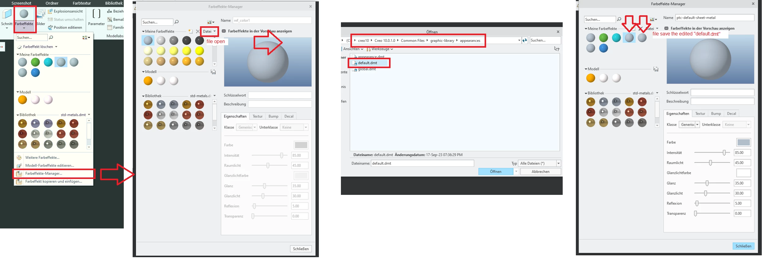

Sep 17, 2023 5:56 PM UTC
Yes, it was my initial idea, that the colors had to be configured somewhere in the .scl file.
But as it turned out PTC changed the "default.dmt" file. If anybody else is having the same issue and you want to change the "uncolored" solids and sheetmetal, I attached a screen.
