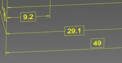

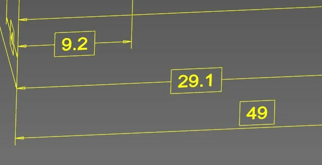

in 3D model, using Annotate I create the Annotation feature to define the dimensions.
Is it possible to change the position of text for all dims (parallel and above) using any config option ?
see the dim "49" in the the pic !

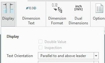

October 8, 2019
File > Prepare > Change Detail options (last one in the list)
October 8, 2019
Ok thanks.
It works.
