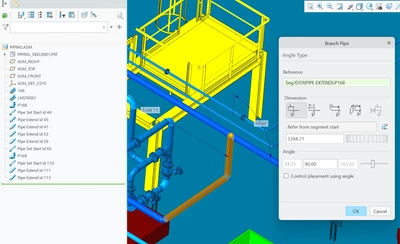

The "branch" command does not allow me to select the line to connect the tubes
The "branch" command does not allow me to select the line to connect the tubes, what could be happening?
Jun 28, 2024 7:40 PM UTC
Hi Jonathan...
It appears you're trying to "branch" into the same pipeline you're already running. You need to branch into a DIFFERENT pipeline. Start a new pipeline and route a small piece. Then you will be able to connect to it using the branch command.
Thanks!
-Brian
Hi Jonathan...
Thanks!
-Brian

Hi Brian
Your comment helped me a lot, I did exactly what you suggested and it worked perfectly
