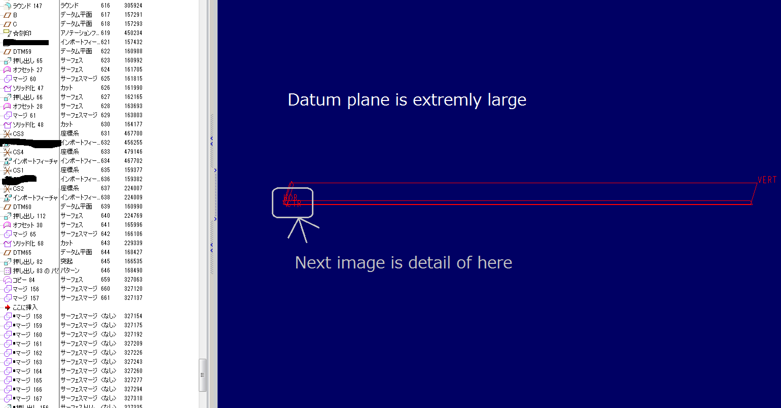

I'm in trouble, for datum surface is extremely large.

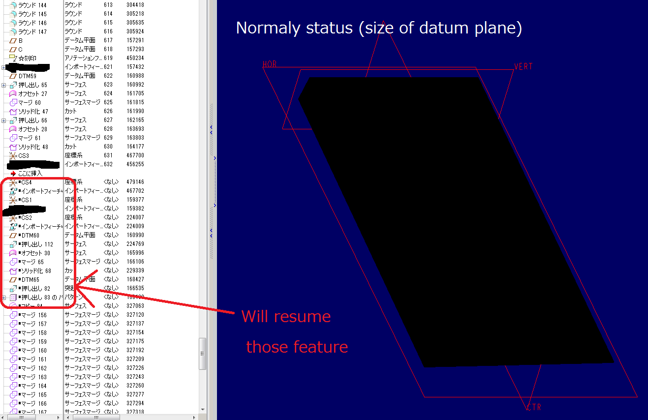

On "Model tree", When I play a certain feature, datum will be very large.
(30 times the size approximate model)

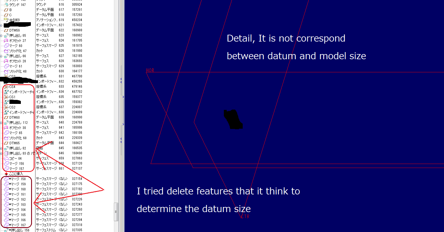

I have tried to remove the features that were the problems seem,
I did not reach resolution.
I think, invisible features ( such as cross-section for the sketch ) are causing a problem.

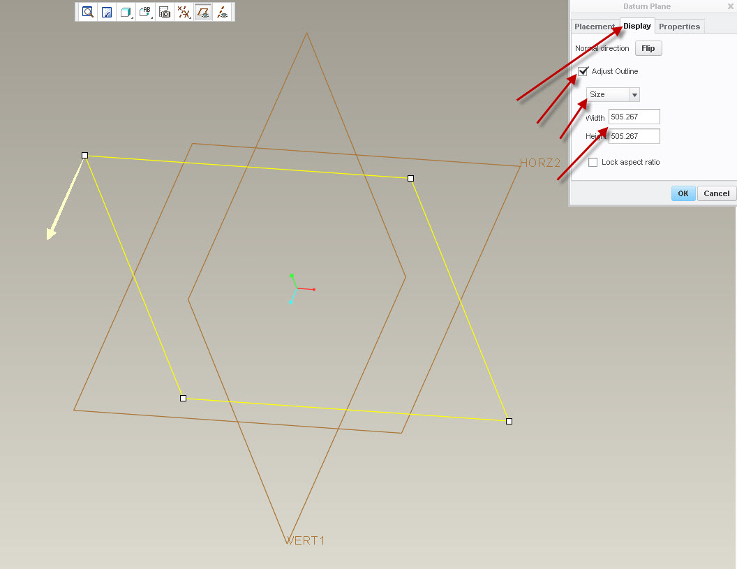

Are you talking about a datum plane, like a default datum plane or one that was made? If so, select the plane, right click edit definition, display tab, select the adjust outline check box, select size and then you can tell the plane how big it is in your units.

In case of Datum Plane you can modify the size of its outline - simply edit its properties.

I've prepared the image.
It may not perfectly meet the requirements.
I'd appreciate it if accustomed to assist in resolution.

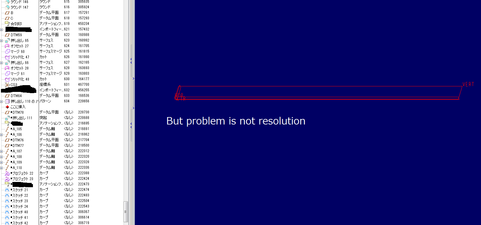

I can change size of a datum plane, but be adjusted individually datum of a hundred pieces already present is not practical.
And further, it is also required datum to be newly created.
I think the most important practical problems is
1st: Losing sight of the model on default view (Ctrl + D, e.g. 2nd and 4th image)
2nd: That the center of rotation of the view is crazy

I remember a problem in older version of Pro|E. We could not figure out what the issue was and often remodeled the part when the problem surfaced.
In Creo, you can permanently resize the datum plane and axes as part of the datum feature. However, this does not solve the screen zoom/refit issues.
