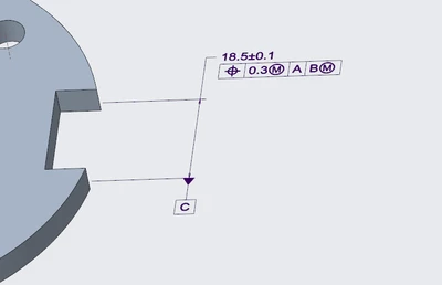

Just tried to update a Creo 3 dwg in Creo 4.  Total. Nightmare.  Something that should have taken less than an hour and I'm STILL not done.  I couldn't get the datum to work (I wanted the width of a keyway) and found it flat impossible to actually fix it in the model.  Somehow PTC has taken away our ability to actually apply ASME Y14.5 correctly.  I had to fudge it in the dwg because I couldn't force datum C to apply to the width of the keyway and attach it to the dimension.  So, now I get that stupid red underline telling me I have a redundant datum.  off.

Hello @Patriot_1776
I am sorry to hear that you are not satisfied with the new ribbon and GD&T creation workflows. We actually received good feedback on the streamlined placement workflows and also about the contextual ribbon. we are contentiously working on modernizing all of the annotations types and by the time of Creo 7.0 we have covered this modernization for all type of annotations but the symbols (which are planned for Creo 8.0).
I have looked into the workflow that you have mentioned about placing a datum C on a width of a key-way and place it on the dimension. this is possible as you can see in the below image. I hope that this is what you've meant:
You can also place the datum on the dimension witness line without having the Gtol in between.
If I misinterpreted your workflow, please clarify with an example.
As it goes to the changes that were made to datums (or as we now call them DFS - Datum feature symbols). Creo 4.0 have essentially introduced an alignment with what the recent ASME and ISO standards were requiring for datum placement. This requirement was that set datums shall no longer be referenced by Gtols. In other words, it is no longer allowed (per the detailing standards) to be placing datums on axis, mid planes or any other non geometry entities and referencing those datums in Gtols. The datums must be placed on real selectable geometry.
We at PTC understand that it might take time for users to adopt the new rules and that they might have legacy models that contains the use of set datums - this is exactly the reason why we have introduced in Creo 4.0 M060 and later a tool that helps with converting your old set datums into the new DFS.
The tool is called "Legacy datum annotations conversion".  There is also a supplemental documentation and examples on how to use the tool.
In addition, if it is still desired, a user can place a datum on a hole geometry and add the axis itself as an additional semantic non placement reference.
I hope that this information will help you to easily adopt the newer versions of Creo

I also forgot to mention that all of the model side annotation do propagate to the drawing, so there is no need to fake it there. all you need to do is to show them
