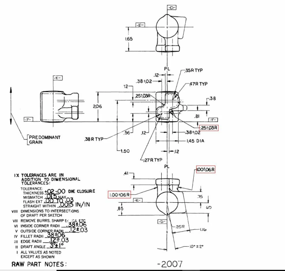

The radius highlighted in RED I am not able to achieve

I'm lost.  Do you mean the model fails regeneration and will not construct the RADII (plural)?
September 19, 2019
may be I did not explain it properly,sorry.
Not able to get those highlighted in red radius on the 3D model.

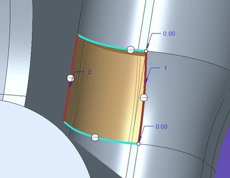

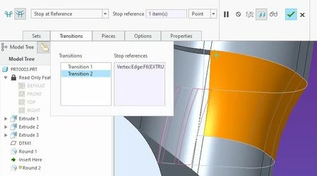

I was able to recreate drawing.  The 1.00R was the most difficult.  The transition in the corner had to be manually created after ending it at the end of the large radius.
Create 1.00R with stop at reference transition.
Project curves onto surfaces, create boundary blend and solidify.
Build mounting feature last.

This is quite typical of conversions from manually drafted components. We have the benefit of endless (nearly) accuracy that was not possible by hand drafted methods.
Draftsmen were highly skilled but when it comes down to things like fitting a radius that is 1.00 inch or is it 0.99 that fits they would be able to draw it because the gap at that scale is not perceptible. I suspect if you modify the rad slightly smaller it will work for you.
