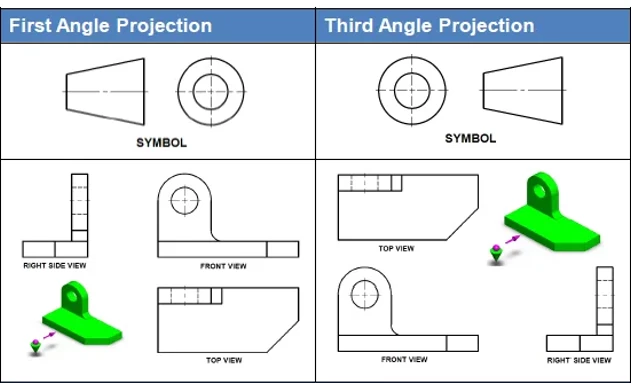

I think you are asking about first angle projection. Open the drawing detail options by typing "detail options" into the search (its not in the default ribbon):
Search for projection_type and change the value from the default of THIRD_ANGLE to FIRST_ANGLE

I don't understand your use of the term "reflection". Are you trying to mirror your part to make a right-hand/left-hand part?
Or are you referring to creating views that are projecting incorrectly?
Maybe you are wanting first angle projection and the software is defaulting to third angle projection?

Thank you. I was looking for this. Sorry for explaining my issue so bad
