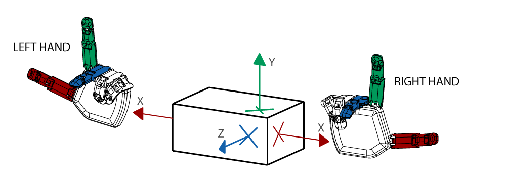

Csys Orientation
To determine the orientation of a Csys use the following commands:
IF_@ NORM_VECS_RIGHT_HAND_CSYS Reference1 Reference2 Reference3
OR
IF_@ NORM_VECS_LEFT_HAND_CSYS Reference1 Reference2 Reference3
END_IF_@
Reference1 = "Name of 1st reference" (Should be a datum plane or plane surface = X reference)
Reference2 = "Name of 2nd reference" (Should be a datum plane or plane surface = Y reference)
Reference3 = "Name of 3rd reference" (Should be a datum plane or plane surface = Z reference)
@ = increasing number
For better understanding see image below:
I hope that helps.
Greetings Sam
