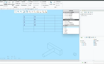

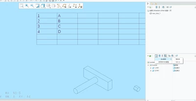

Hello everyone, I created a component in 3D, and then created any simplified representation, such as NO-A, N0-B, and then saved it. Then I created a new engineering drawing and selected a simplified representation such as NO-B, but the repeated area still shows component B. How can I solve this problem? Thank you

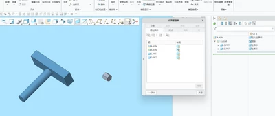

The repeat region BOM will always show the model/representation of what was active at the time the BOM was made until you change the Model thru the repeat region menu.
Table tab > Repeat Region > Model/Rep > Select repeat region (table) > Select model > Select representation > Confirm > Done

uploaded video show how to remove B item from repeat region.
Note: You do not have to define simplified representation in A.asm
