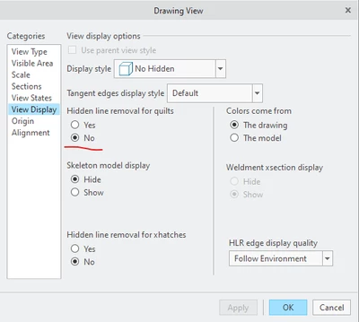

Assuming you are asking about cosmetic threads, in the drawing view properties, select No for Hidden line removal for quilts.
