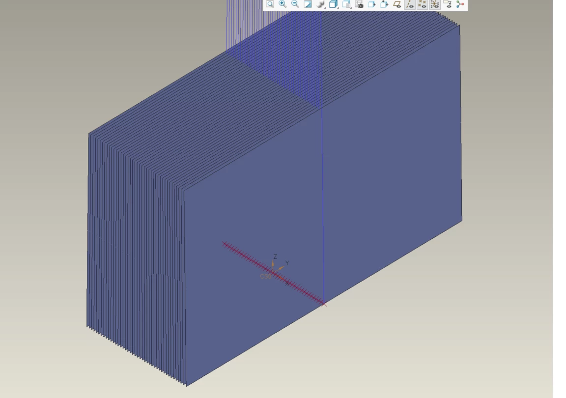

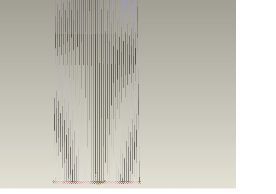

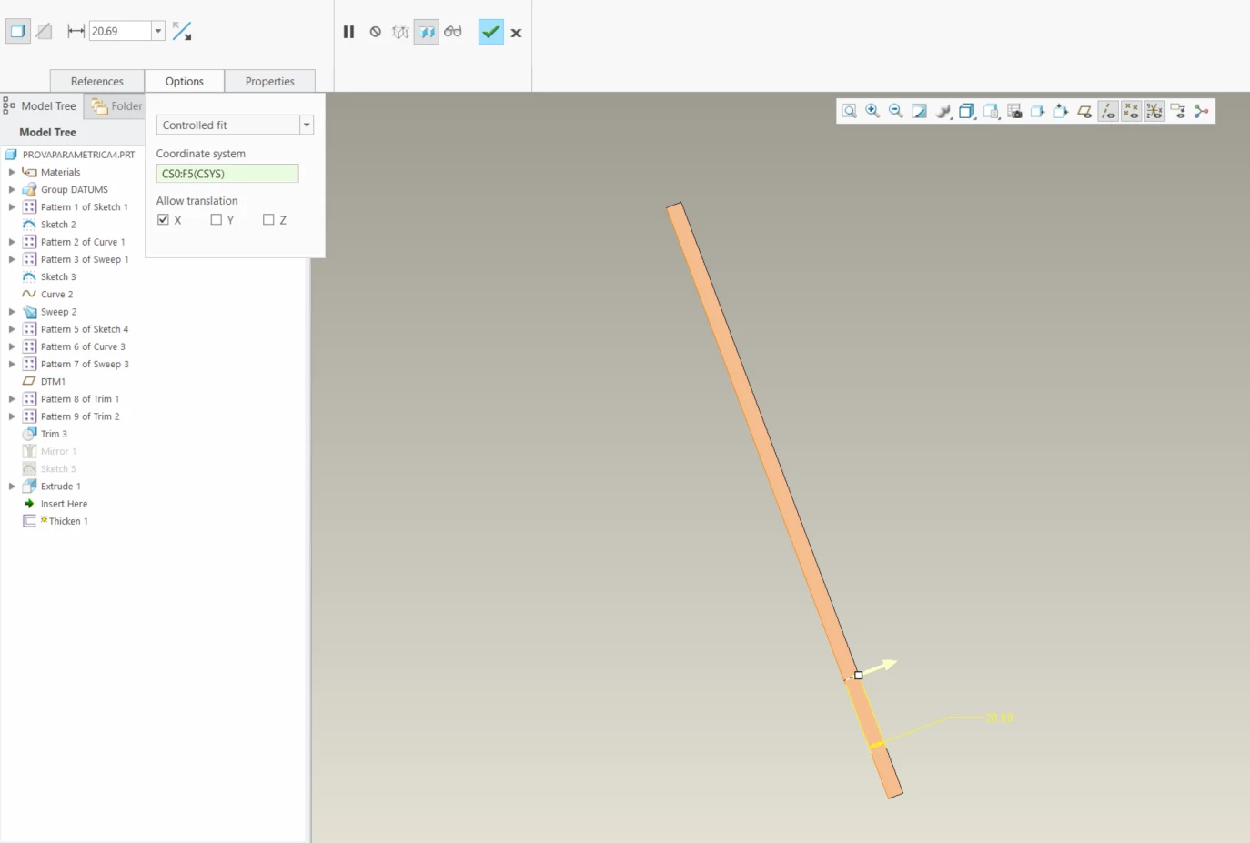

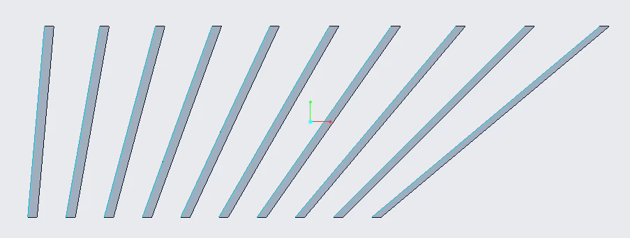

I am struggling with giving a thicken a surface in just one direction, that's the X one, and then I need to do the same for every surface I have created with a pattern.

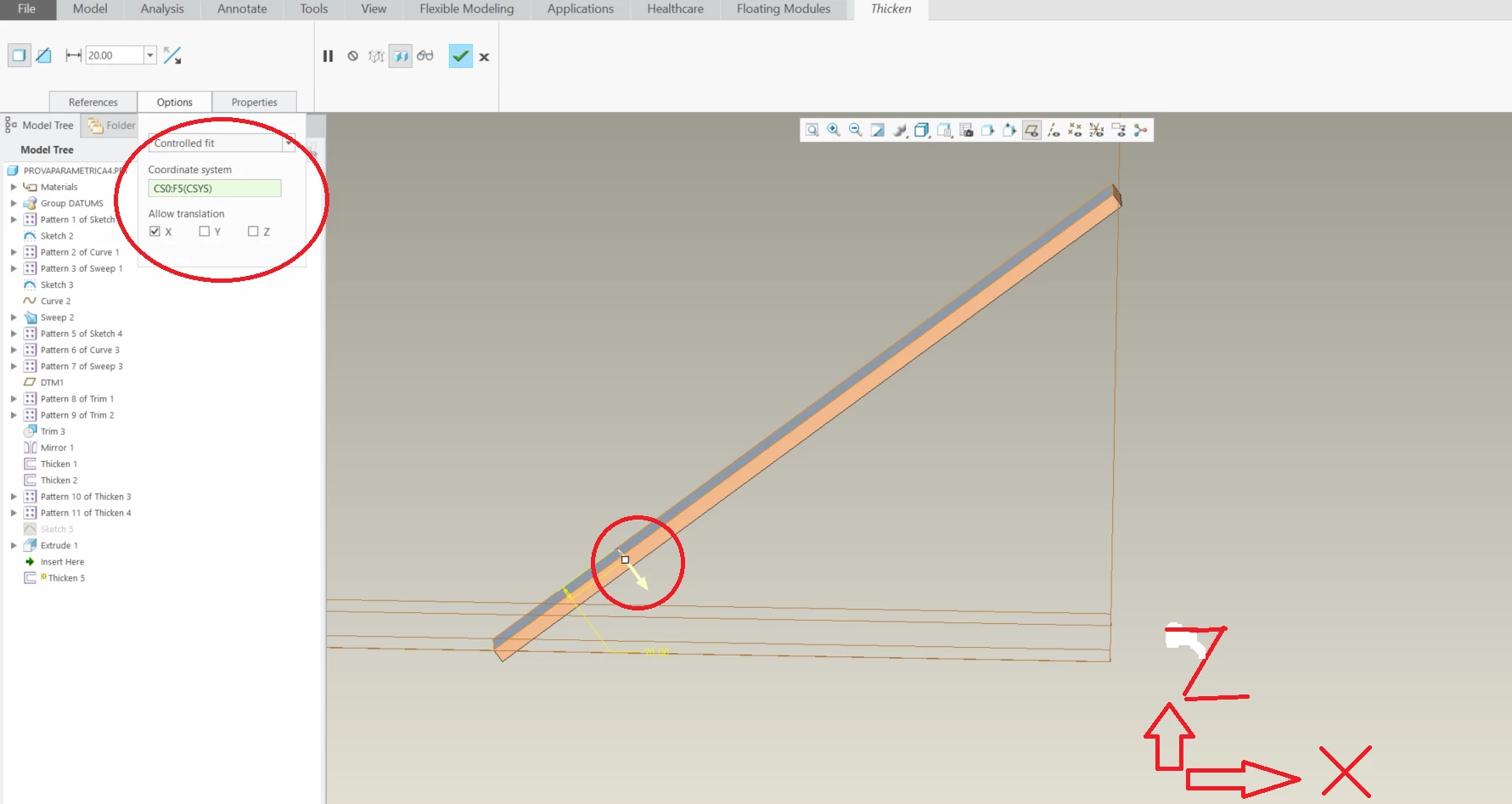

But I have realized within the Thicken tool in Options there's Controlled fit and you can choose the direction - but I did some trials and it didn't work (it creates the thickness only normal to surface)
It's not too evident, but every surface is flat and focused - so the mid one is straight and the others have an inclination (the more you go to outwards the more the angle is higher).
Probably I am unaware of how thicken works - anyway there is also a picture with an inclined surface to show how I apply Thicken to have the extrusion just in one direction.

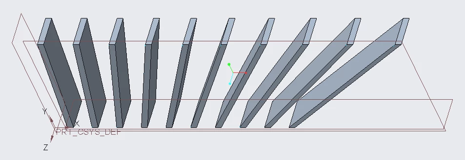

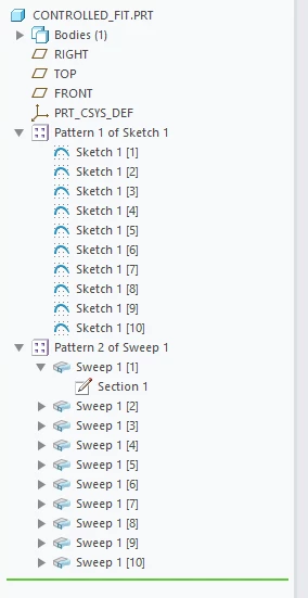

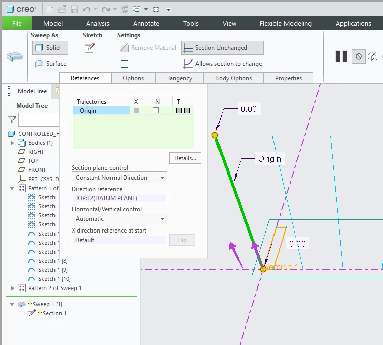

what about this:
Uploaded model is created in Creo 7.0.

Let's forget about the pattern and all the rest, and let's talk about the thicken feature.
In Thicken feature, in "Option" there is the possibility to activate the "Controlled fit" and to tick the box x/y/z in order to make the thickness in a certain direction. However, any box I tick, nothing happens and the tool makes the thicken always in normal direction of the surface.
Final purpose is to have an inclined parallelepiped with a constant section along Z obtained from a surface that represents it's symmetry surface.
Please, let me know if the question is clearer now.

Jun 17, 2022 8:44 AM UTC
what about this:
