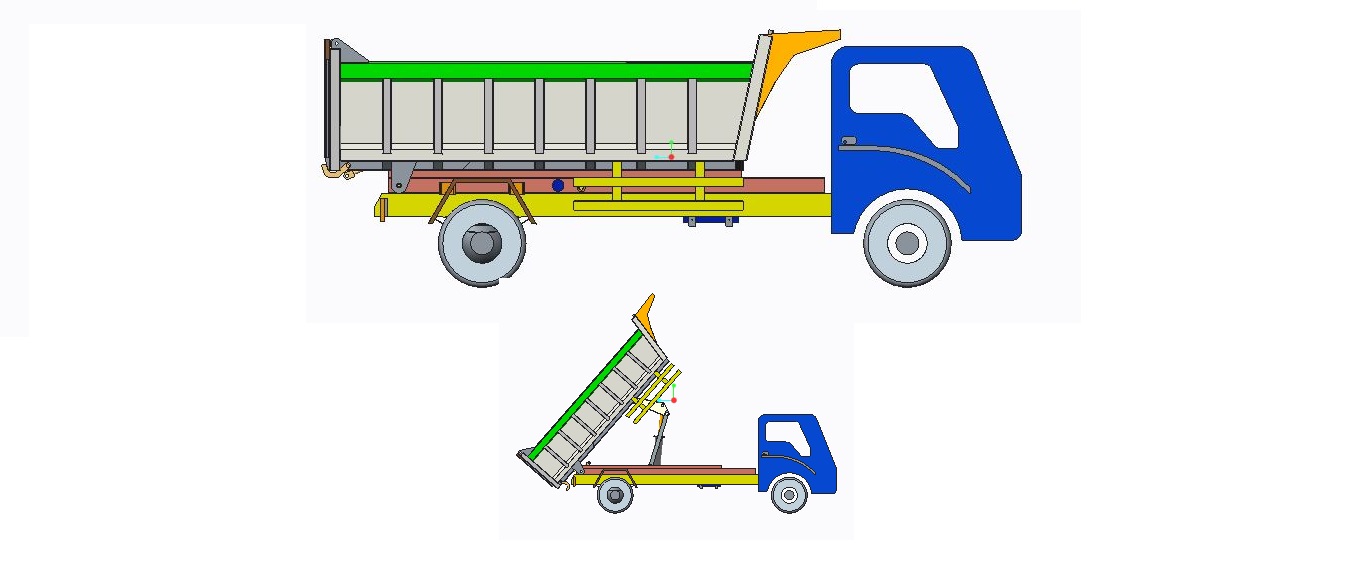

Creo.JPGI can put two diffrent views in drawing module.as shown in figure. how i can create this.
