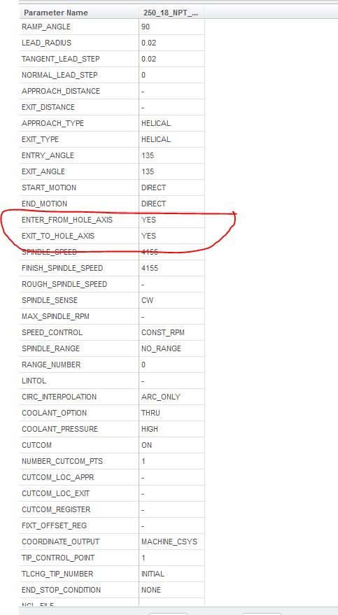

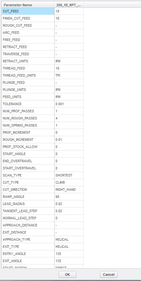

what type of thread internal external or npt? single point or multi thread threadmills The threadmilling routine is fairly simple to use since Creo1.
Here are the parameters I use for a 1/4 -18 npt multi thread thread mill in steel.250-18npt+parameters1.JPG
I circled the best parameter which is the start from hole axis. That used to be a pain in the butt as well as multiple passes but now in Creo 2 it's painless.
Steve

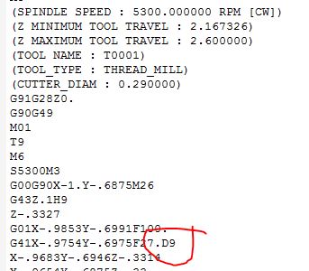

I have used the threadmilling sequence several times (Only internal threads btw) but was never able to use it in combination with the cutcom option. Did you ever worked with this before? It would be helpful to use this option while i changed the diameter several times to get the right size in diameter, but when the cutcom option is working you can change that at the machine.
Best regards,
Paul
Jun 9, 2014 11:44 AM UTC
Cutter comp works in threadmilling. Just make sure you have a leadin leadout set and turned on.

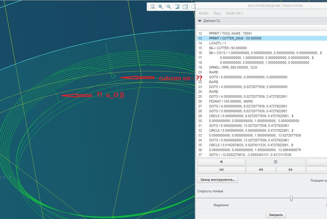

Hello, Michael! I'm interested in Thread Milling tapered threads with an angle of 1.79 degrees per CREO3.
We get in the path of the 3 coordinates lines. Radius compensation is incorrect?
Привет, Майкл! меня интересует резьбофрезерование конических резьб с углом 1,79 градуса в CREO3.
Получаем траекторию перемещения в 3-х координатах линиями. Коррекция на радиус не отрабатывается?

Hello Olga,
can you explain further, what you mean with "get in the path of the 3 coordinates lines"?
Radius compensation is something you can define, but not really simulate in Creo, since the actual compensation value will be added on the machine.

Hello, Gunter!
sorry my bad english!
can you explain further, what you mean with "get in the path of the 3 coordinates lines"? - we get Move around lines 3 coordinates:
X17.275 Y1.95 Z-2.428
X17.697 Y1.802 Z-2.44
X18.076 Y1.564 Z-2.452
Radius compensation will not work.
when milling holes for threading
