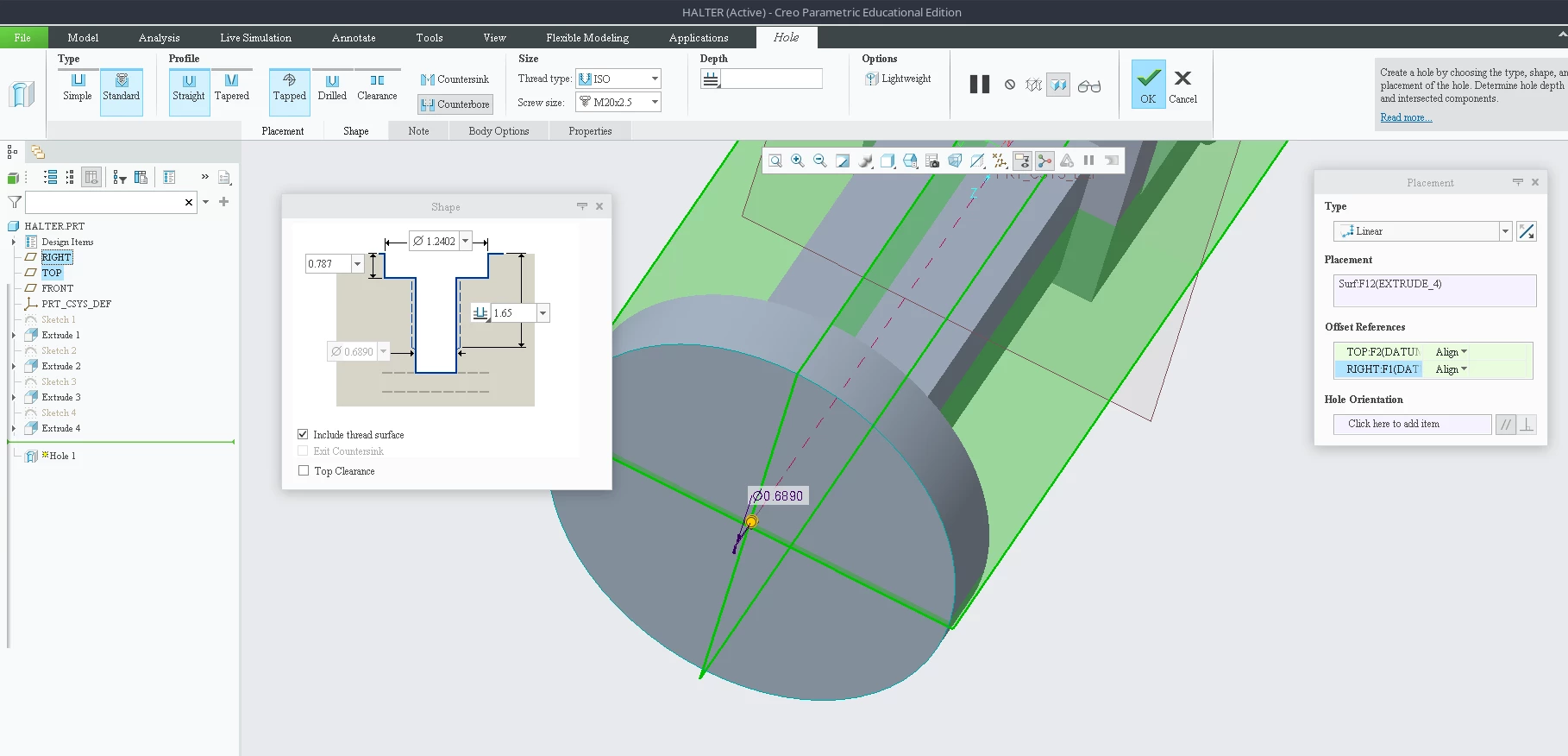

Hello dear Community,
I am a student having worked with Autodesk Inventor for a while but i am switching for a future employment.
When trying to make a threaded hole i select ISO as the thread type and M20x2.5 as the size but then it spits out sizes like 0.6890 for the inner hole diameter wich is propably in inches, but since everything is set to mm it tries to make a hole for the thread thats just 0.689mm in size.
Screenshot is attached aswell i couldnt find any solution via google / this forum but maybe i was just blind, if you could give me an answer or point me to an already existing Answer i would greatly appreciate it.
Software: Creo Parametric Education Edition (Version 10 i belive)

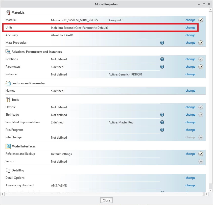

Sep 29, 2024 1:32 PM UTC
click File > Prepare > Model properties.
I guess you will see following information.
