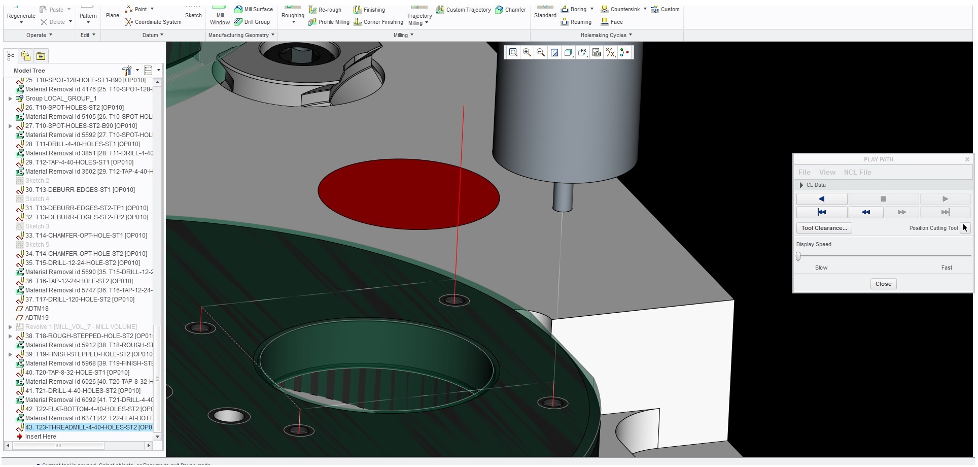

When creating a threadmilling sequence it seems that it is trying to plunge from the operation retract instead of the sequence retract. I have it check to not always use the operation retract. I have a plunge feed of 30 ipm set and I want it to rapid to .100" above the part and then plunge with the feedrate. This only occurs of the first hole.
Any help would be greatly appreciated. Thanks!!

This could be a version problem, I remember this happening to me a couple of years ago.
Try Cero 2.0 M040.

I am on M040 now and the problem is still there. Heres to hoping its fixed in M050.
